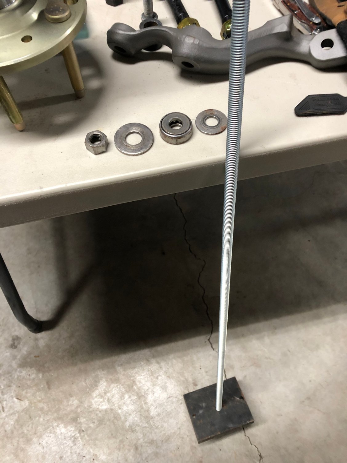

You can also use a piece of all thread to help remove and put back together . All thread some kind of plate for bottom couple washers a bearing and a nut. But still be careful
