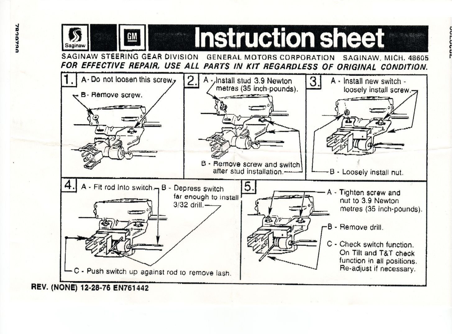

Since the column is out now, check both ignition and dimmer switches for proper adjustment.
If the dimmer switch is not adjusted properly it will put allot of stress on the wiper/washer pot metal pivot bracket.
Instruction Sheet for NEW switch installation.
Mark ignition switch position, follow steps 3-5

This is GREAT information....thanks! That's the only part that worries me. I do know the rebuilder is putting a new ignition switch on, so I'm assuming it'll be all set or will I need to tweak that during my install?
Thanks again!
