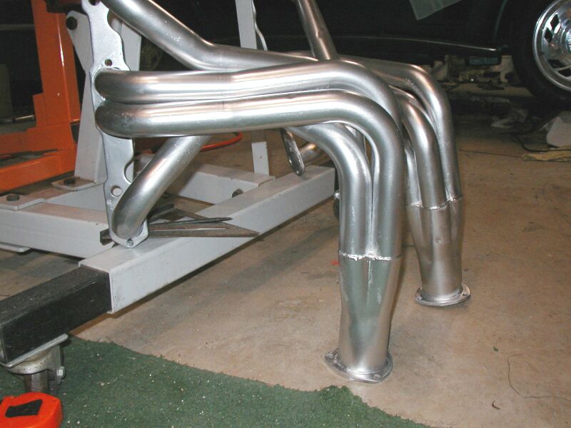

First thing before exhaust. Oh I live in Reno. You need to buy a exhaust pass under cross member. It simplifies the exhaust system. You install full long tube headers. Then install dual exhaust straight back from the headers. Use a cross over pipe like an H pipe or buy a X pipe to install
I went with 3 inch pipes because the future might include more power

You save labor money for a pass under exhaust and keep heat away from the transmission. Easy to unbolt the exhaust to work on anything. Just in my house garage I unbolted the exhaust system to put in my spare different gearing differential. I am done racing so I went back to 4.11.
I made these back in the 80's and they are still working fine 15 engines and 10 transmission R&R later

You can buy a cross members for pass under exhaust. Like Bowtie Over Drives or G-force. I installed my headers at home and just drove it with uncapped headers to the muffler shop. They welded up the 3 inch system.
