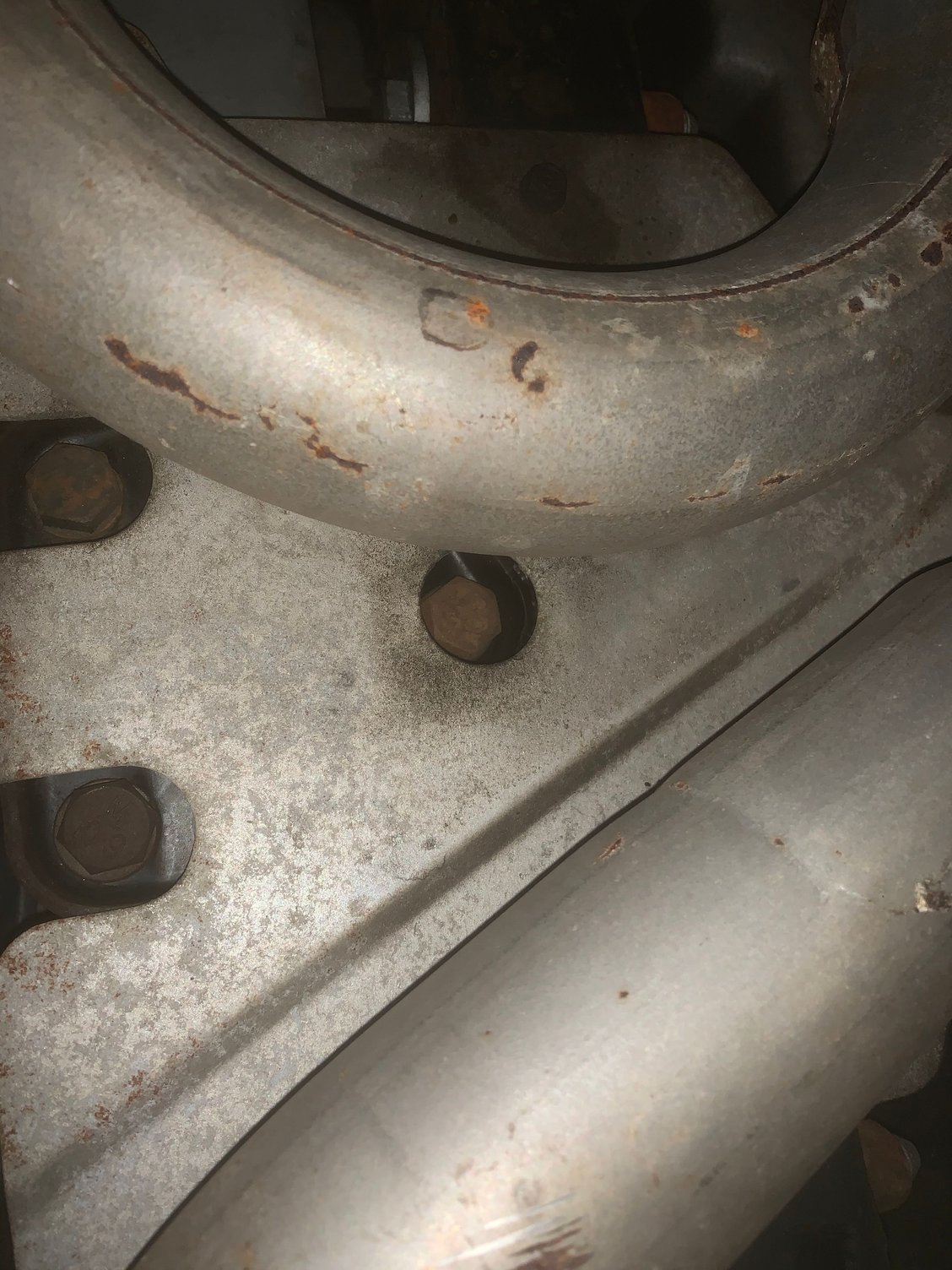

I am old. I am forgetful. Get that out front. I thought I read somewhere that the 1982 Corvette differential came with a drain plug. It was the only year C3 to have one. I could have been delusional because I can’t find any reference to that in the Shop Manual.
I attached a photo of what could be a drain plug between the exhaust pipes.
Does anyone know for sure 1) if that is true and 2) if there is a drain plug, the picture is of that plug?

Read through this link, no drain plug.

My 82 crossfire does not have a drain plug, I bought a cheap suction pump from harbor freight and sucked it out.

No drain plug. Those are actually the three bolts for mounting the rear spring. The 80-82 used three bolts to mount the rear spring instead of four like the earlier years.

I have an aluminum 1982 differential crossmember with the differential cover as an integral part. I just went out to my garage to look at it. It has a drain plug..or perhaps more accurately a fill plug. If you remove the plug, you'd need a suction pump to completely drain the diff.
Why do I have a 82 differential crossmember? I thought that to save some weight, I'd use the 1982 all aluminum differential crossmember, aluminum differential housing in one of my early C3s. Abandoned this idea when I found out the torque rating of the 82 rear end is very low.

Yes the 80-82 did have a fill plug in the batwing but there was no actual drain plug.
