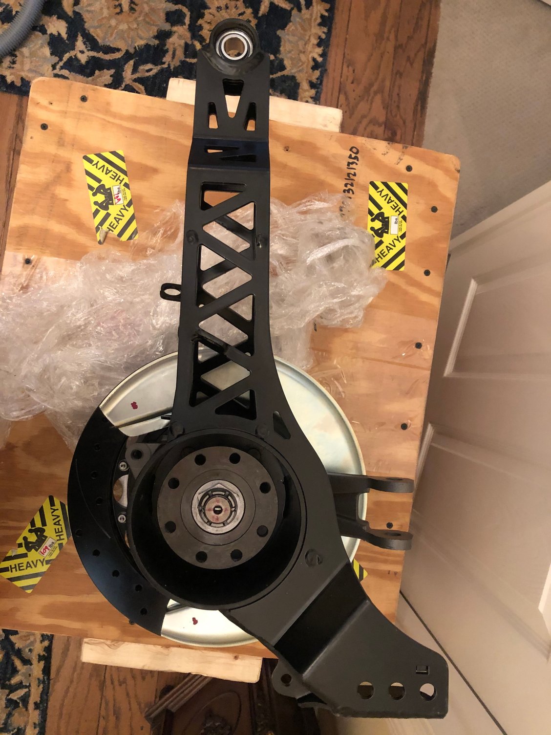

I had Gary build both my diff and trailing arms. Excellent service and worth the wait. Just got the Ridetech arms back from him about a month ago and hopefully life will allow me to install them this weekend. Rotor runout was .001 and .002.
