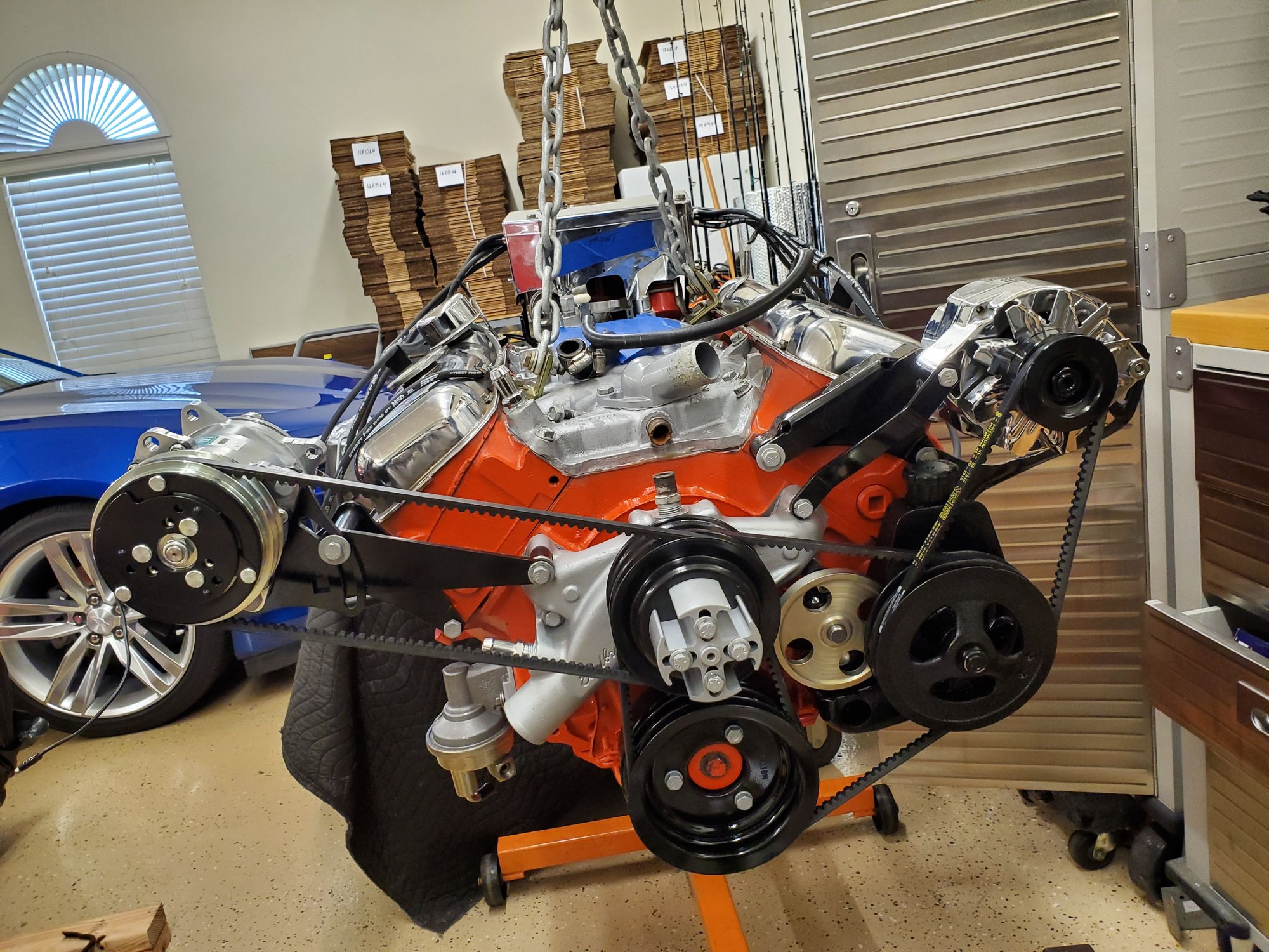

Yes I have 2 belts from crank to water pump. One just broke. It looked old.
here is my belt set up.
Old Sep 5, 2020 | 02:51 PM
Z06CE's Avatar
Z06CE
Joined: Apr 2013
Posts: 302
Likes: 16
Do you have a idler pully that is pressing on the short second belt?

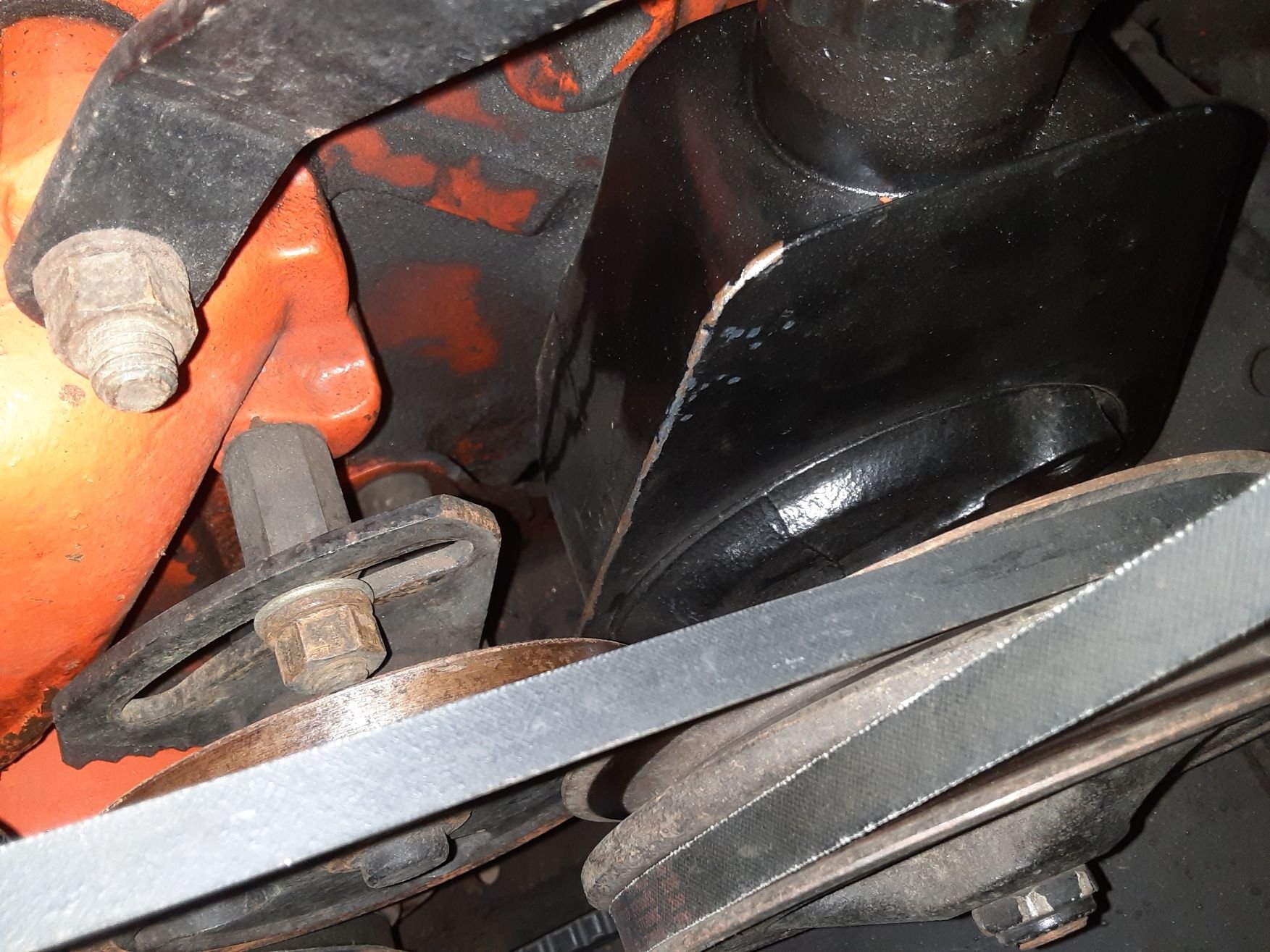

First of all, have you ever replaced the wp to crank belt? It can be tricky. There are several threads about replacing the wp to crank belt. You might be able to install a new belt that is tight enough so your compressor belt won't squeal and not need the idler pulley.
The idler pulley pushes in on the belt to tighten, and can be adjusted more to compensate for belt stretch later as it wears, if needed. It's simple to install.

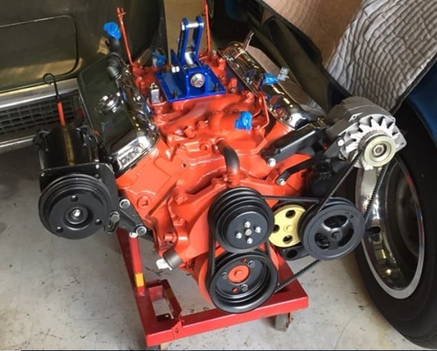

Here are the aftermarket parts, you will also need a lock washer and nut for the adjustment stud.

thank you. No I have not ever replaced that belt. Looks like a difficult job. I guess I will install the idler pulley as well. I assume there is an empty hole on the front of the engine for the bolt? This is a non air 427.

The bottom idler mounting bolt and spacer shares a hole with the lower power steering bracket. The holes in the idler pulley are there so you can use a socket with a short extension to access the lower bolt. The upper adjustment stud replaces a water pump bolt.

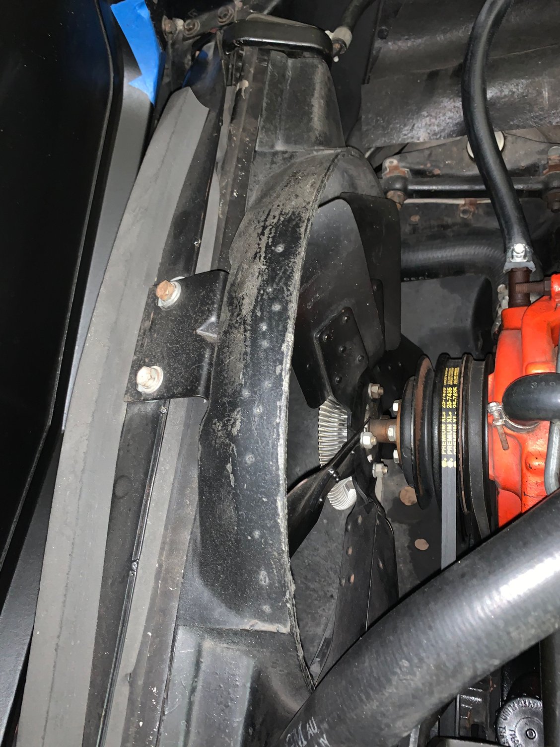

Looking at the broken belt. It was pretty dry rotted. Maybe a new good quality belt will work without the need for the idler?

I've removed my idler pulley before and I didn't have to remove anything when I re-installed it. I had plenty of room, put the stud in first, then place the idler pulley slot onto the stud and start the washer and nut to hold it in place. Then you can hold the spacer in place and put the bolt through and screw it in.
Originally Posted by Z06CE
Green 454...That's a cool load leveler!
Thanks, but not mine...I borrowed the photo for reference.
I would try that first and see how it works. You can think about the idler pulley later. Do you know what size belt you will need?
