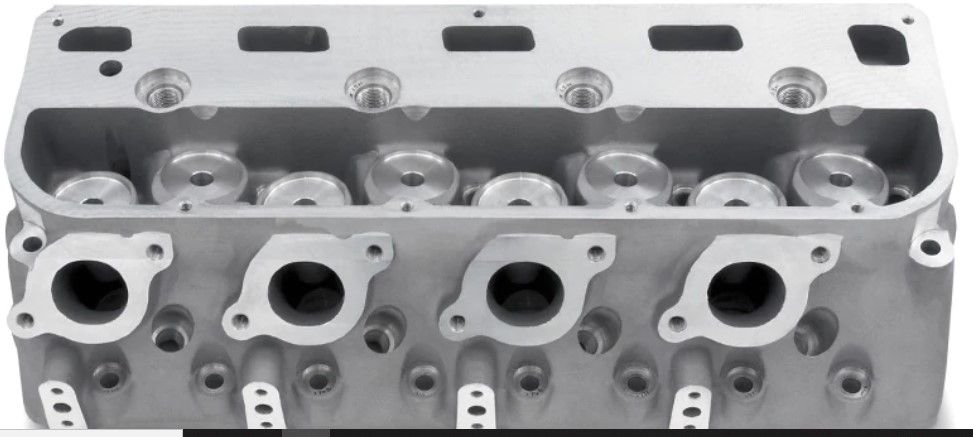

Here's a thread from august about two sb2 or splayed valved SBC chevy engines for sale.
Somewhere around 900-1100Hp
Shairoff says a street tuned version could make 900 HP and be perfectly streetable!
https://www.corvetteforum.com/forums/c3-tech-performance/4429177-saw-1100-hp-smallblock-chevy-today.html
https://www.chevrolet.com/performance-parts/components/engine/small-block/splayed-valve-aluminum-race-cylinder-heads
Yes this is a SBC head. GM even. Non siamized exhaust, canted valves, not inline. This is the splayed valve, not the SB2.
