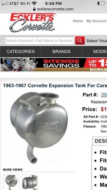

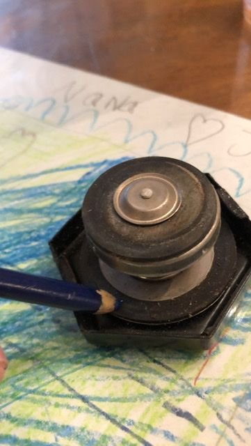

Guys I have a question cars that use this style tank does it use a gasket where the pencil is pointing? The one we are dealing with has none just the lower one. Thanks in advance.

That is not the correct cap for that tank.
The aluminum tanks require a RC26 cap to prevent galvanic corrosion and it does have the gasket under the cap cover.
Your profile states 75, why would you have a 67 tank?

Because I have a friend with a 72 with that style tank. I noticed the gasket I indicated was not there and was wondering if it should be.

no it shouldnt. I dont know if it would even fit easily

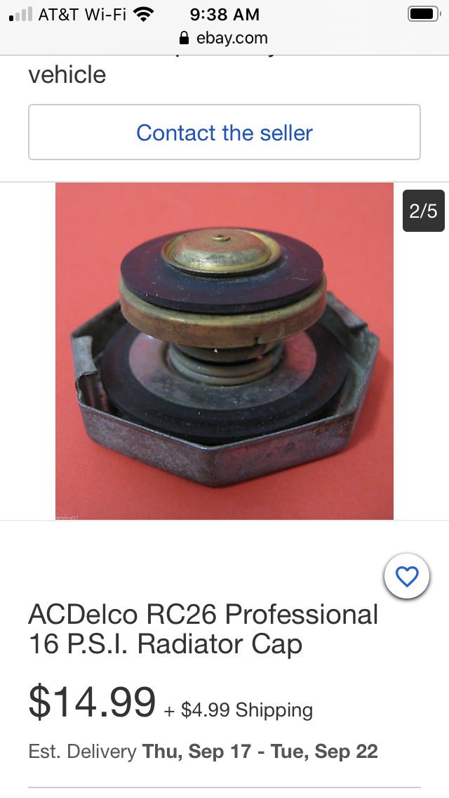

Here are 2 photos of an original RC-26 the upper gasket is correct.

That’s his cap minus the gasket.

I found 2 on Ebay both show a gasket. I have to agree that it would be tough to tighten with that gasket there.

Thats the wrong cap, I know it says, RC26, but the original cap is 15lbs not 16lbs.
The cap shown by me would have been the original cap on any 1972 Corvette with an Aluminum radiator and expansion tank. With upper and lower gaskets.

After looking at a beat up original on ebay it appears it should have the upper gasket
https://www.ebay.com/itm/Original-Co...-/264623682676
