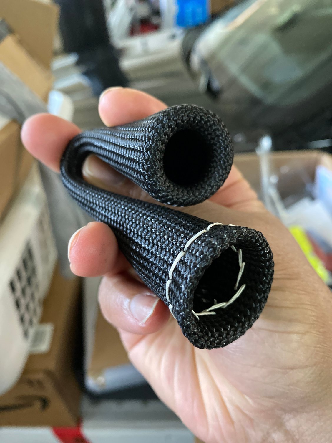

Underneath would have been the smart way of doing it. This was done by the shop that built the motor. I even bought the wire heat shields but one end has some sort of washer sewn in and I get the 90 degree boot to slide through It.

I have those boots or socks too, but in red. I believe they are Moroso. In my opinion they were too long. So I bought just one set of four and cut them in half to make eight. If you cut them in half, the sewn-in steel ring will come out. Its not needed.

Routing the spark plug wires on these cars is no easy task and does not allow for much deviation from factory. Being my first Chevy (from Ford) I can't believe how easy it is to screw up. The heat shields next to the 2-3, 5-6 plugs is critical, and in my limited experience the fiberglass cloth insulators shown in Post 4 will only work for a few hundred miles.

I bought some more header wrap. I will remove the finned looms along with the wires to give me some more room to work and try to wrap up the headers.
