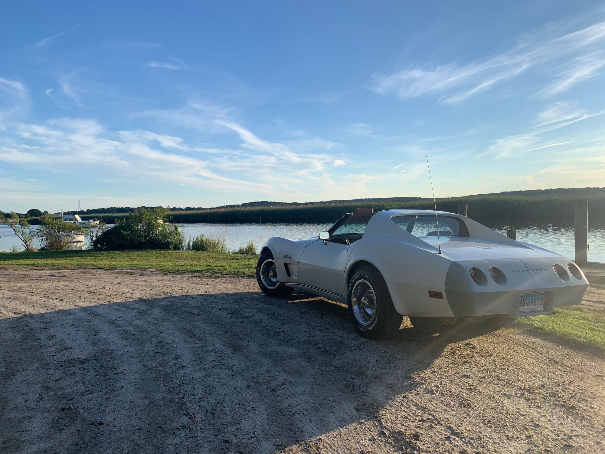

I've got a 1974 Stingray L82/4 speed and I'm looking for advice on bolt-on upgrades that won't break the bank. I'm not looking for big power, just something around 325-375hp to wake the car up a little bit. I had in mind heads, intake manifold, carb, cam, and headers but am not sure of many of the specifics. I'm a 19 year-old college student and eager to learn whatever I can about my car. Any advice or suggestions are greatly appreciated.

I'm jealous. I didn't have a ride like that when I was 19!

Thank you! I was lucky to get it and get it on the road, with the way the DMV has been lately. A lot of people did me favors that day. Do you have any advice for the timing advance?
