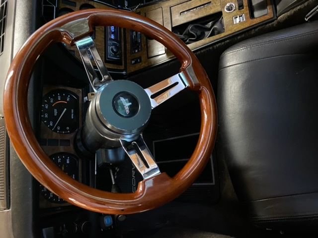

I had a set of the repro ones and they were loose, enough that the button would wiggle and beep the horn when hitting dips in the road, speed bumps, etc.
Ended up just using some plastic nuts/bolts from home-depot. installed, trimmed off to length, worked perfectly
The reason one's in upside-down is the nut was just hitting the tele-screw beneath it and the bolt head is thinner so I flipped it for some clearance

Nice picuture. Thanks for the leads everyone
