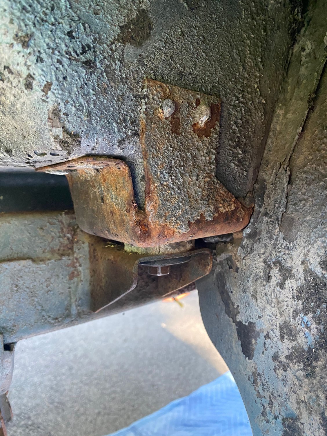

I have had to cut out the bolts on the rear body mounts on my convertible 68. Question is, how do I now go about repairing the lock nut that broke loose inside the body?

Photo of the mount I’m referring to

Are you referring to the cage nut inside or the reinforcement in your picture? The cage nut is is riveted to the body inside of the rear pocket. To get to the rivets the reinforcement in your picture will need to come out or you can use a large neoprene washer, a steel washer, and a nut. I'm not too familiar with the convertibles but I think it is easier than a coupe model to get to the cage nut.

yes the cage nut, which will be accessible from the top?

Yes the cage nut is attached on the top. It is riveted to the fiberglass. To get to the rivets you'll need to remove the reinforcement underneath the car which is not that difficult. Looks like yours may need some attention, either cleaning and painting or replacing it if it is rusted out.

It's right under the rear deck spring but you can get to it.
Are you after originality?
If not you could always just "pop-rivet" the cage in from the top or leave it out.

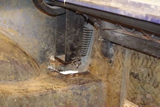

Have a look here, some pics on how the nut looks and how I dealt with it
https://www.corvetteforum.com/forums...oval-tool.html
M
TLDR
If I knew, I would have found a 1-1/2" inside tube and put it right over the cage and may not have sheared the rivets. Run a chaser up through the net and put in a new bolt.... hindsight

Thanks for that! I like that tool you made! Might be a relief for my buddy to know its not an impossible job!
​​​​​​​Can you sneak in a new metal cage (pictured above) without lifting the rear body that much?

I didn't want to lift the body so I needed to modify the mount on one side in order to slide it in place. If you look near the bottom of the thread I posted above it shows what it looked like
