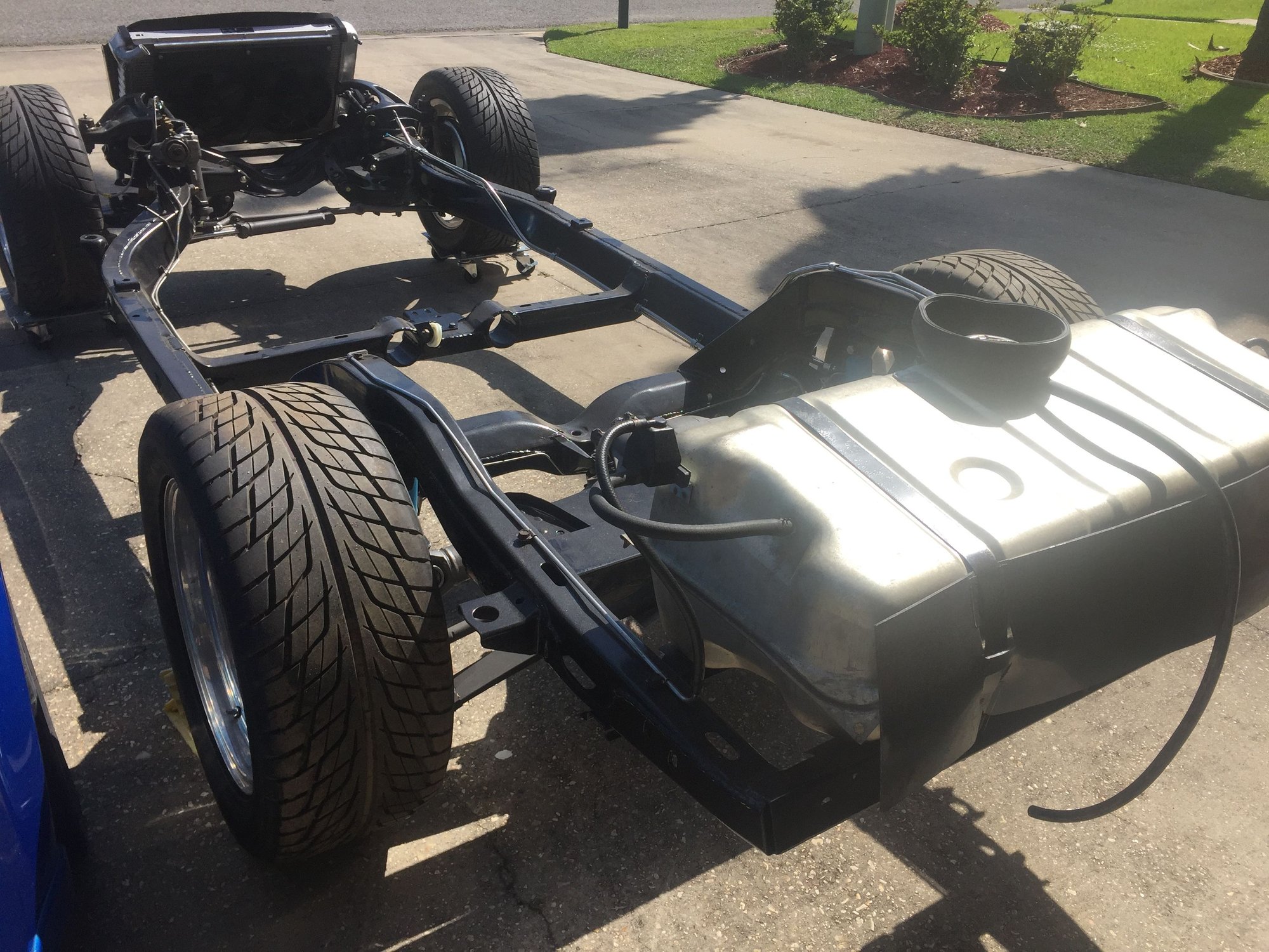

This is the frame on my 1971. You can see the holes. It is a 4 speed car so the crossmember is welded in.

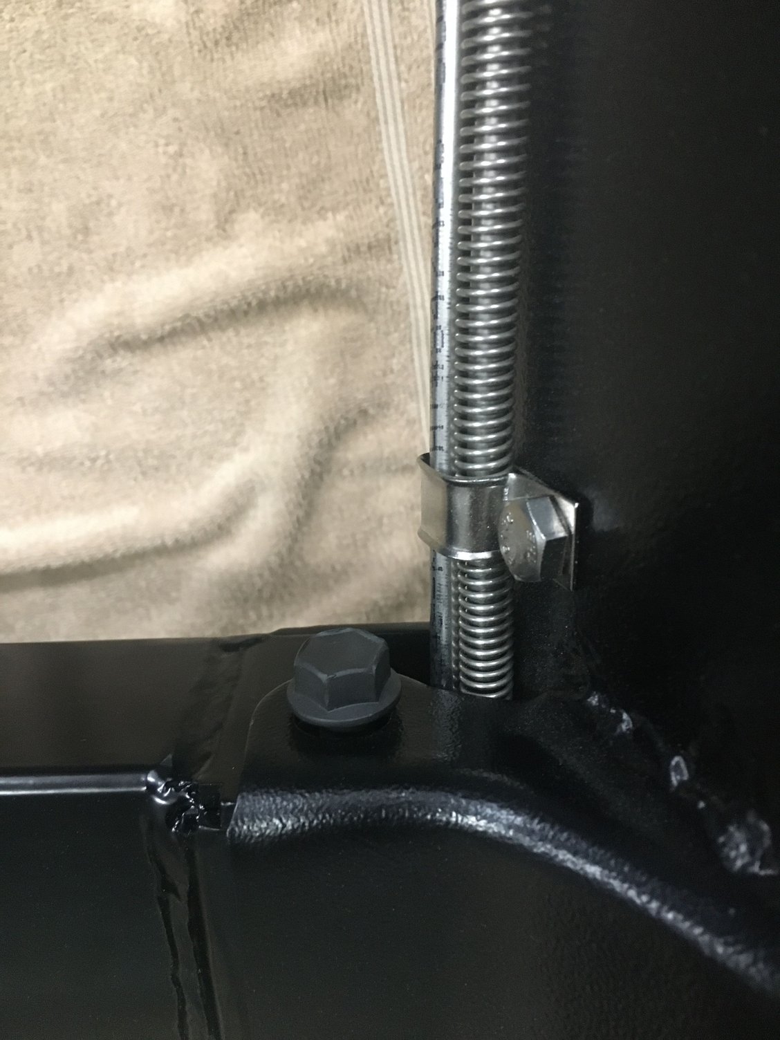

This is the drivers side. I see both statements as being valid on the orientation of the bolt. I like the idea of protecting the threads so I’ll flip the direction when I get home.
