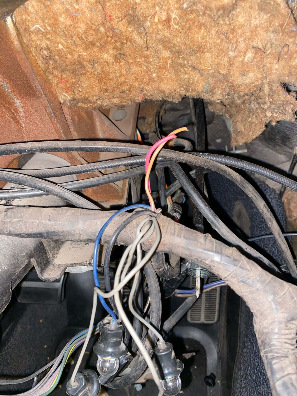

working on a recently purchased 1968 convertible SB manual. i have two sets of wires cut off i can't identify. Any help appreciated.

Hey Vince,
Congrats on the new purchase!
I don't have my diagrams in front of me right now, but if memory serves the Pink/Tan will be for the Park Brake Indicator bulb. The Yellow, Orange, Lt. Blue will be for the Heater Switch Connector or the Heater Resistor.

pink and tan should be for the parking brake light
blue orange and yellow are for your heater resistor connector

Lt Blue/Orange/Yellow is the Heater resistor connector
Tan/Pink should be the Parking Brake Alarm bulb

Thanks for all the rapid replies. This will really help. Now to figure out why he cut them in the first place...

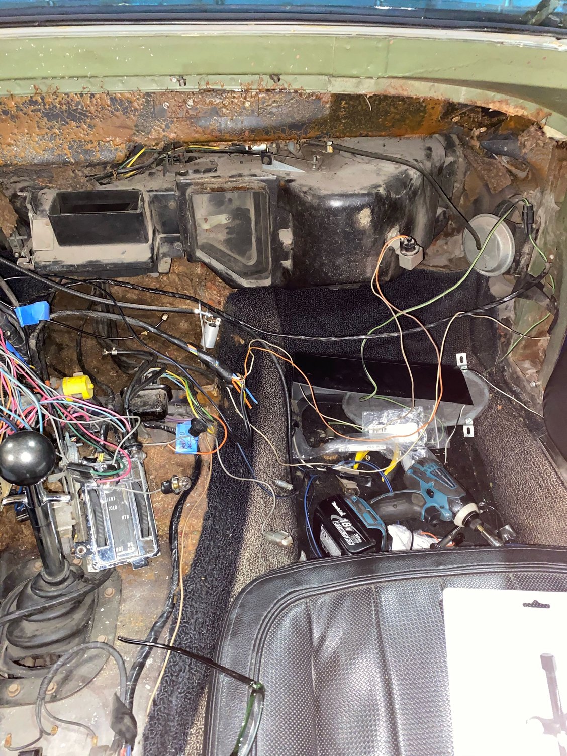

Yours looks good. My 68 had plastic wire nuts, taped, and bare wire splices. Add the leaking oil pressure line, cracked floor boards, etc. to the mix and it was a wonderful month or so fixing all that mess. I do agree that if you don't have an AIM you should get one. Good luck and enjoy.
