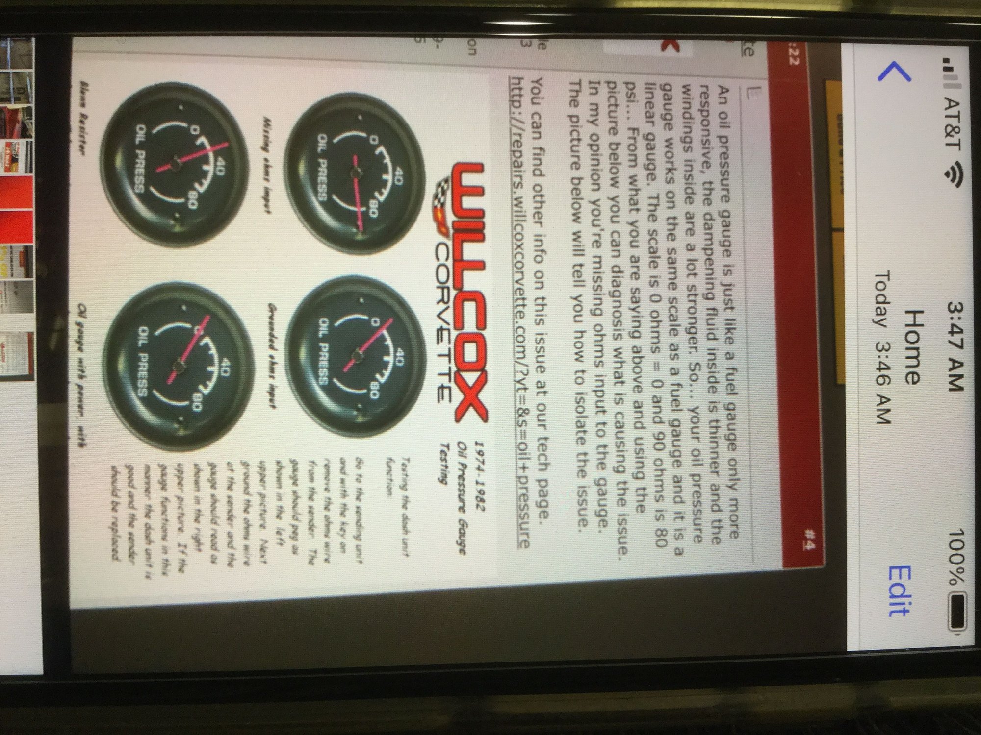

Willcox has great information on various system trouble shooting and repairs.

You will need to follow the instructions on the right side of the sending unit to ascertain if the problem is the Wire or the Gauge. Certainly, it’s less pain if you don't have to dig into the gauge cluster. If you are lucky, it’s a frayed, broken, or grounded wire.
