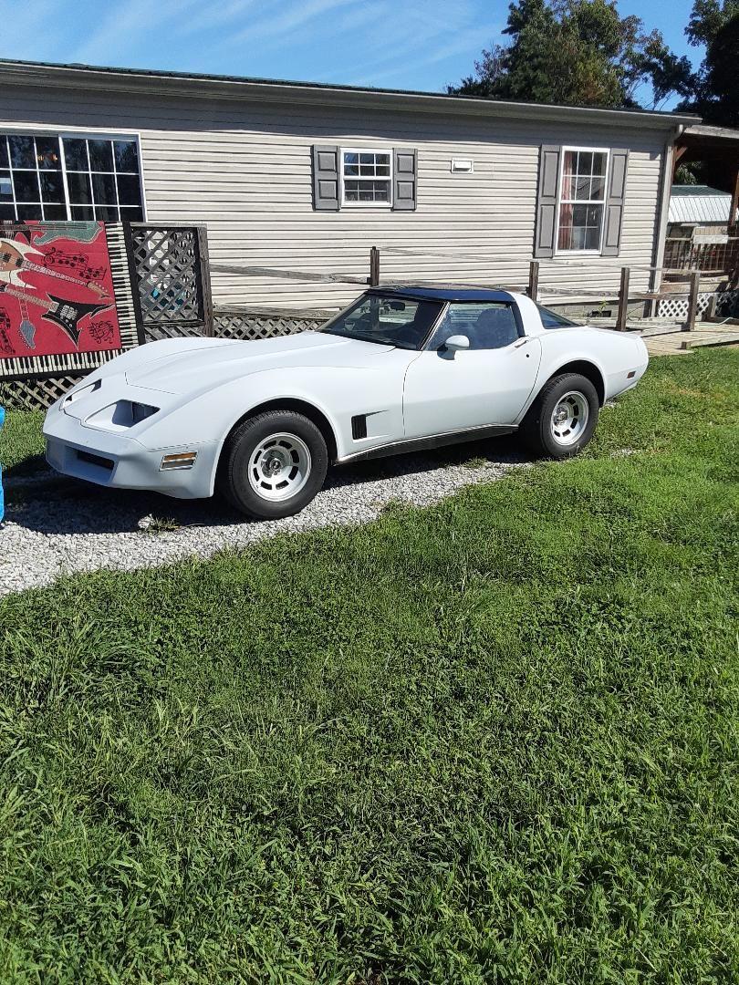

well i bought another c3 but this one is in need of help the previous owner just hacked it up they removed the following
spare tire holder carrier assy the whole thing
improperly routed exhaust
removed all the ac/heat stuff even under the dash all duct work also
it has a different motor/trans but ehh ok
retro fitted the 4 headlight system and that was done wrong
hacked up the electrical system
so here we go, currently where I am on it is the complete body has been replaced with a NEW after market one, rear panel, front nose, front clip, fenders, rear section, and fenders, the doors have be redone, and the main house cabin has been redone,
the engine and trans is a 1968 Chevy 327 freshly built small cam aluminum heads and a turbo 400 trans
I have completely removed every wire and have replaced it with a "easy 22 circuit wire harness" like a painless kit it went in and now everything works
I had to install a complete door lock system from auto loc
i installed the low oil pressure light and the no charge system light
i have updated the center console gauges with equuis gauges
thy hacked up the instrument cluster so i had to just put equuis speedo and tack in on a aluminum backing
i am currently working on rewiring the door lock switches to be compatible with the auto loc kit
i have installed all new seals
i have some pics below don't freak out over the wiring its a in work evolution and when its done it will be fine allot of it is laid out for tracing and wiring it will be loomed and routed at final assy
the car itself is smooth and currently in epoxy primer but as i proceed and it moves along I will update you

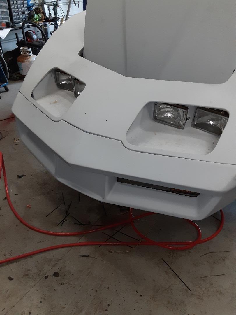

Not sure about the tail, but not thinking it's that bad. It's the lack of headlight doors that bugs me. The 80-82 cars are good looking cars to be sure. But no headlight doors?

yes i am not a fan of the conversion on the head lights, but when they had this car taken apart they removed ALL the factory headlight system, there is no support beam brackets anything no vac sys, its all gone, I could probably fabricate a bracket to put the light housing back, but it would at a minimum need the electric conversion, and speaking of the 4 headlight conversion they didn't do it right either, I had to retrim the holes and refit the buckets to fit where you could adjust the headlights, and if you noticed there is no clear lens in front of the lights, so if I leave it the way it is those headlight holes will just pile up with dirt and debris, so I definitely half to do something with them, just keeping it in the back of my mind for now.

You are halfway to an L88 FIA headlight conversion. Here's an example from a quick Google search. Embrace the racecar look! That C4ish bumper has to go, though.

omg that's horrible........... the ones i have seen the clear lens goes under the body and in front of the lights. that looks like my neighbor said here watch this ... hold muh beer and me saying uh okay...........not lol
