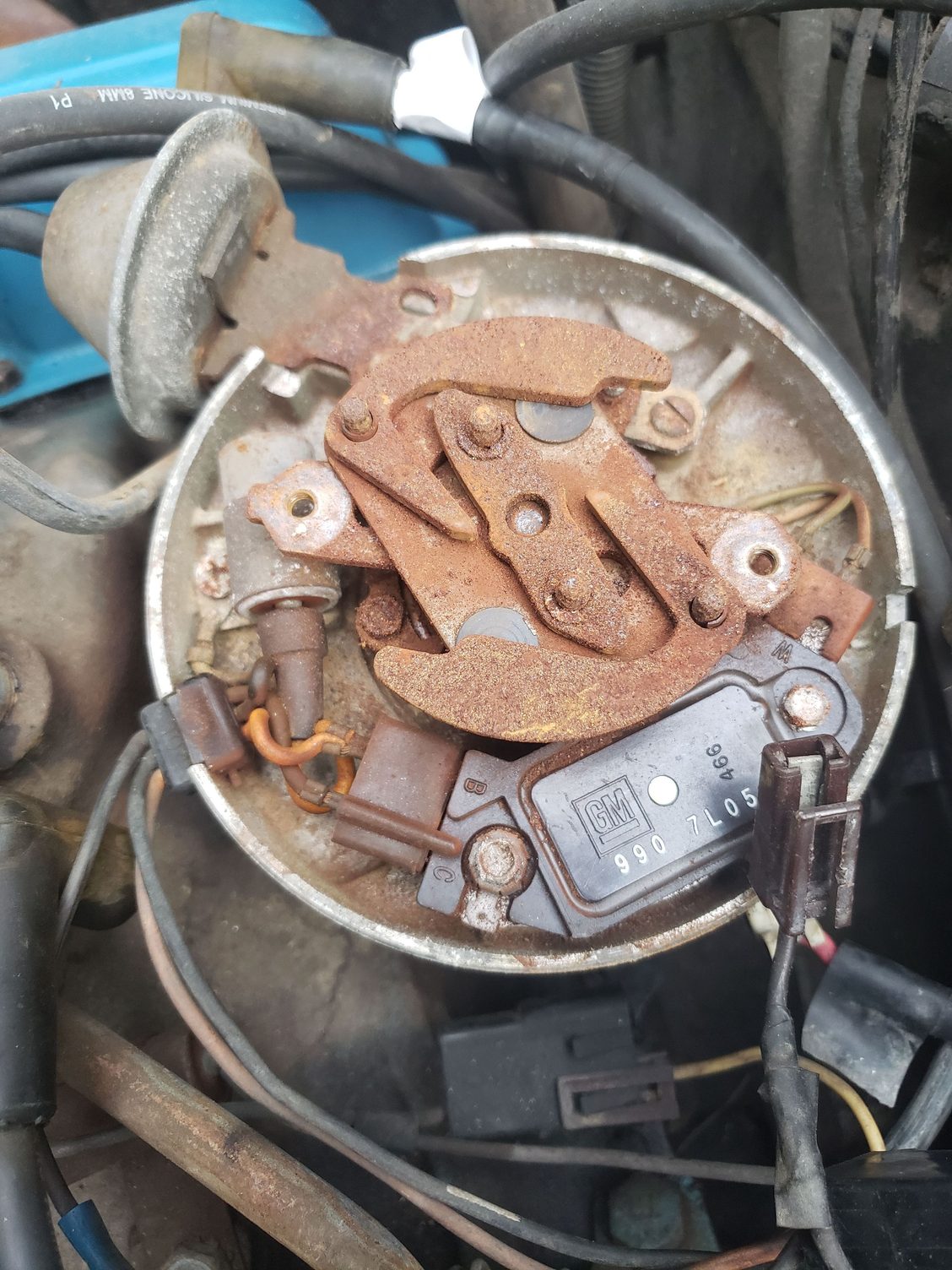

Quite awhile ago, I was asking on the forum about my C3 stalling when I'd let off the accelerator and had been focused on fuel issues. Some folks on the forum had suggested that it was an ignition problem and I finally got around to checking on that. I was more than a little shocked when I took the rotor off.

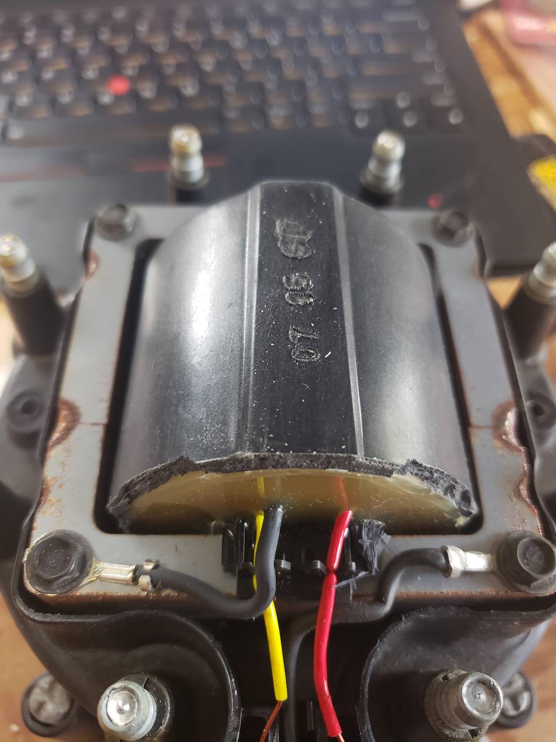

As for the coil, it seemed to pass the ohm-meter tests but I don't know about those damaged areas - will just replace the coil as well.

Did you remove the weight return springs before taking this picture?

Looks like the coil needs a new distributor to attach too.
no I did not. I've not found them yet. I'm going to investigate more today. I'm ordering parts from summit racing - the pickup, the advance kit, coil, etc. just ac-delco.

Time for a new distributor
Yup. Get a whole new unit. Cheaper and already curved.

thank you for the suggestion - as I've researched more, I see that a completely new unit is probably the easier way to go.
