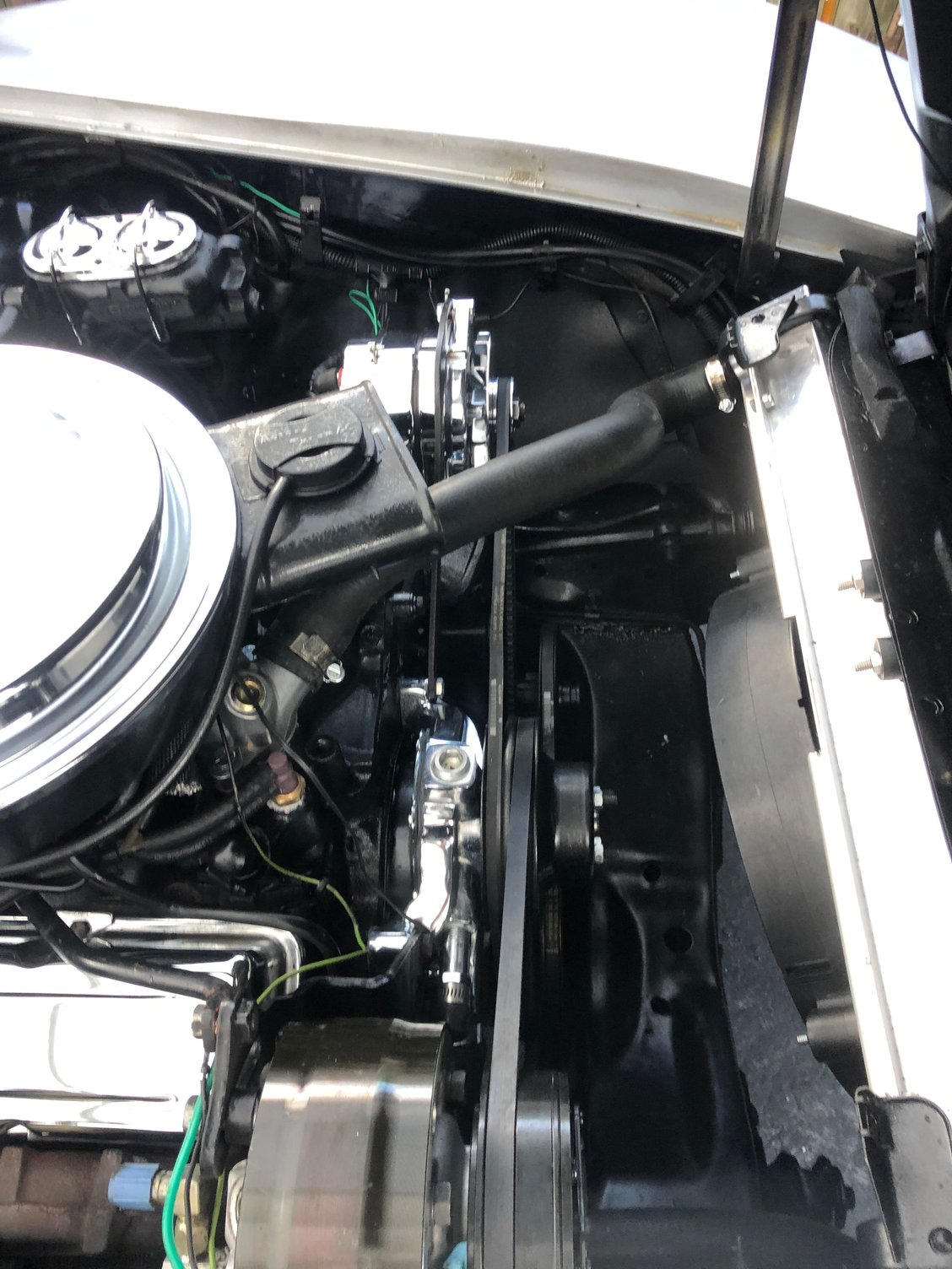

Default Lower radiator hose
Recently purchased a ‘69 C3 with a 350 and the previous owner installed an aluminum big block radiator. I have recently noticed that the lower hose is dangerously close to the fan. Can anyone suggest a lower radiator hose that will allow proper hose to fan clearance?
picture please. Ive noticed calling ecklers or southern car parts directly they will give you the part numbers BUT after market stuff always changes the game. One thing I did learn make sure the lower hose has the spring in it.
