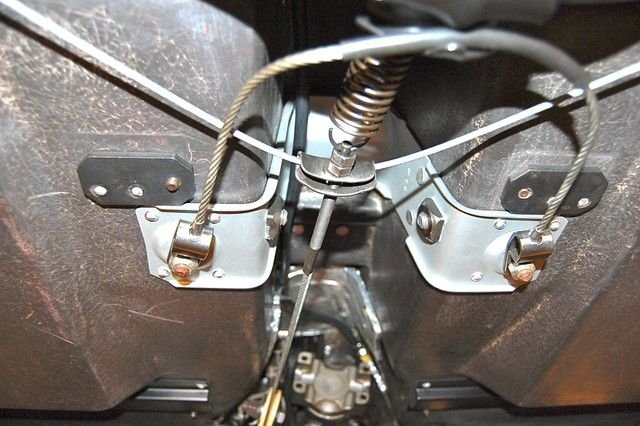

I've got parts to rebuild my parking brake shoes and actuator lever, and the rear parking brake cable since it was installed incorrectly and stretched. Is it possible to just remove the rear cable or do I need to remove the front as well to get the rear cable out at the Equalizer?

Yes, remove the cable at the equalizer first then at the wheels.

Right, but the rear cable at the equalizer runs on top of the front cable, so I assuem I need to disconnect the front cable from the main pullback spring to get the back cable out of the equalizer?
