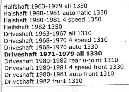

I want to change all 4 U Joints of my halfshafts, and want to go with non greasable ones from Dana, since I read that they are pretty reliable...
Are these the right ones for my 1971 C3
Dana Spicer PN 5-1350X
Thanks,
Alex

Yes.
https://willcoxcorvette.com/catalogs...alf+shaft+tool
Buy or build this tool

Yes, those are correct for your half shafts. I got mine from Dennys driveshafts, but you can get them anywhere. I couldnt figure out how to paste the ad from Dennys, so open the attachment. It tells you what you need to know for sure.
File Type: docx
