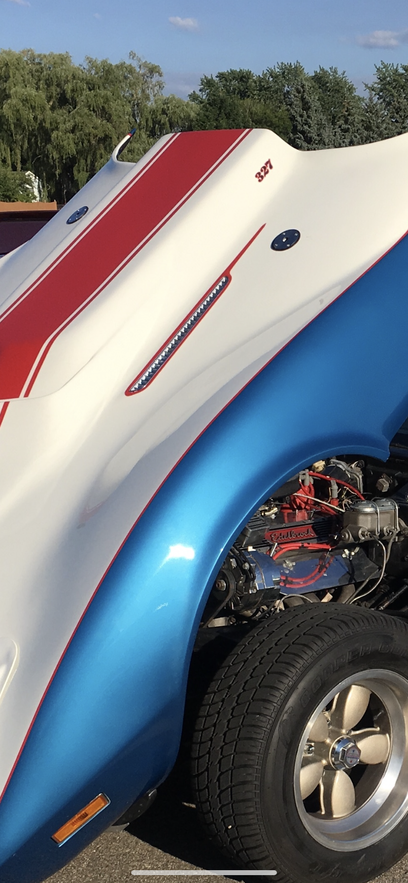

65 396 vette hood vents. Seems to work well

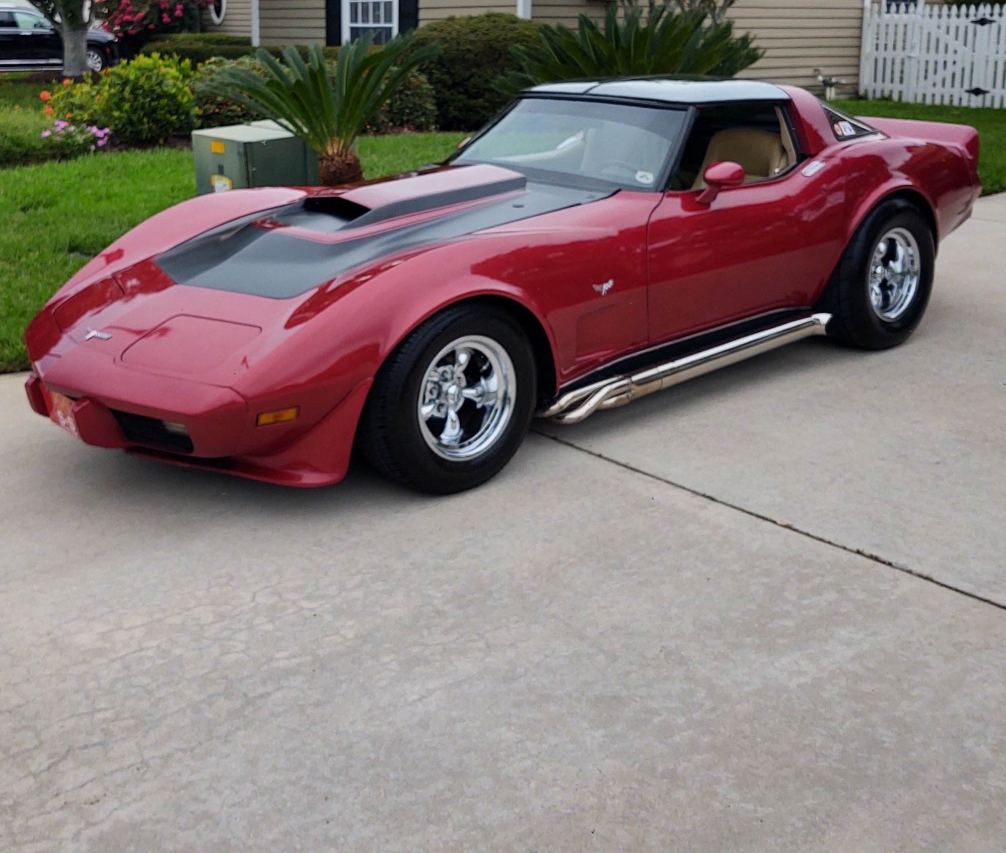

I've noticed several members have installed vents in the hoods of their C3's, like the one pictured below.
I am thinking of installing a hood vent in the new Tall L88 hood I purchased for the restomod of my 73.
My questions are:
1. Did you notice any increased cooling of the engine compartment?
2. Did you notice any performance gains?
3. Was it worth the expense
4. Would you do it again knowing what you know now?
Thanks

I installed one on my LS swap. I can say hot air definitely rise out of it at idle which is exactly what I needed. While sitting at a red light i can see the waves of heat coming out of it. Never saw waves of heat coming off hood before before installing. My coolant temps would rise while at idle for 25+ minutes in 95*+ heat with the ac on. Add the vent and no problems yet. I'd do it again.
Thanks for the feedback.
The installation looks nice and clean and the vent itself looks to be top quality.
Is it aluminum or plastic?
It looks like it will do what I was hoping it would.
Can you supply the manufacturer and the part number?
Thanks again, Greg
that looks nice. I'm going to have to measure in front of my airbox and see how much I have. I was thinking of just opening the port there in the L88 hood where it rises up

This vent looks like it is actually a GM part for a C7.

I have the trackspec vent for the l88 hood. It's a really nice looking piece, well made and good finish. Maybe a but pricey but impressed by the quality. Is aluminum. Hardest part was making sure it was centered on the hood front to back and side to side. Lots of blue tape and measuring.
https://trackspecmotorsports.com/c3-...s-l88-long-kit

Thanks. I have my air filter for the ls where the l88 scoop/bird bath is. I was more concerted about getting caught in the rain more than anything. Too far forward and it rains on the filter or pulleys. I made a little cover for it out of abs in case it rains while it's parked.
