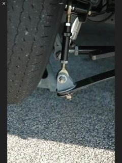

Has anyone used these?
https://www.ebay.com/itm/263493360725
seems a bit expensive for what it is.

I'm not even sure exactly how that's attached to the trailing arm, also not sure I see the advantage... I guess I'm not driving hard enough to experience "any spring float if you encounter negative G."
I think I'll pass, especially at that price point

Had a look. WOW, you wouldn't believe what they charge for these in Australia! And they just replace the hanger bolts! Yup, I'd certainly pass.

I see six threaded joints that have the potential to back out and fail in the most important link in your rear suspension. I think I'll keep the simple bolt and rubber bushings.

$500- for some heim joints and a welded bracket?

aftermarket sells shorter and longer bolts for a few dollars. if you are an autocrosser and need to make a last minute ride height adjustment before a run the adjustable turnbuckle might be nice but otherwise I dont see a need for them.

If you have wider than stock wheels or larger diameter, you use these with a spring that is 1 inch less width. Now you can lower the rear of the car without the spring hitting the tire
