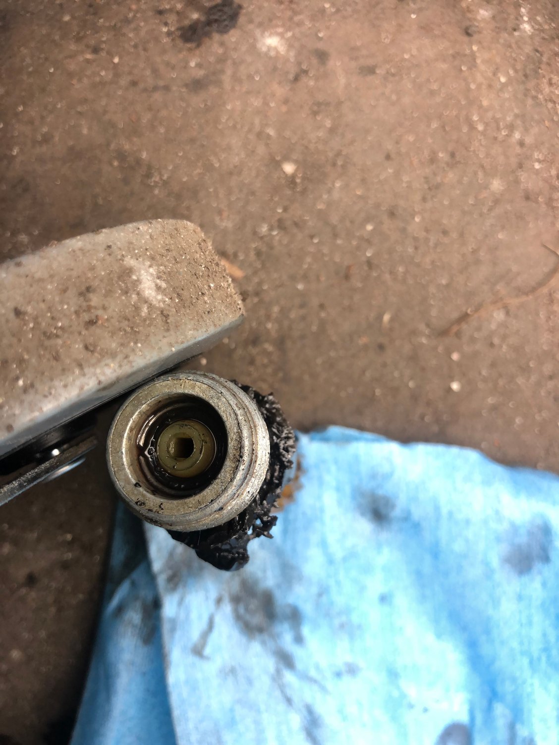

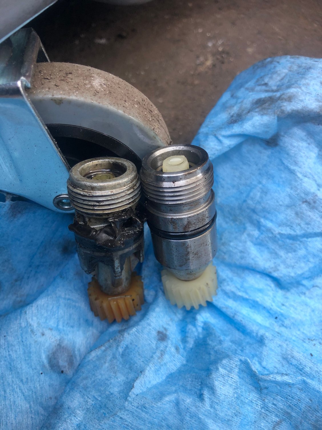

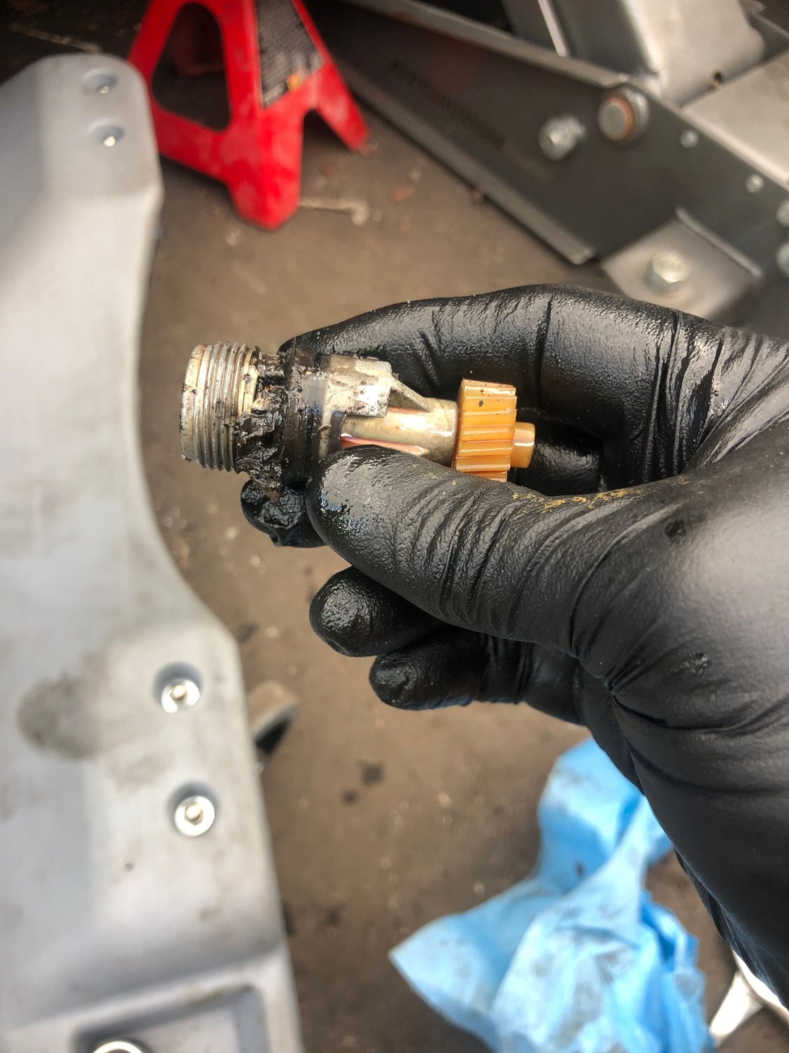

I’ll build a different thread for this bit since this seems to be the ‘restore’ thread I thought to put it here. So a common leak issue for the trans on chevys has been the bullet that your speedometer cable attaches to. Been meaning to replace it and since ‘I’m already there’ replaced it and the gasket for the pan. Check out the pics of the old and new bullet. The leak comes from the non existent o ringt around the bullet body. The speedometer cable is always blamed but that just needs to be hand tightened. I learned this all on YouTube and I wish I remembered the guys name. Google bullet transmission corvette c3

oops yes o ring. The crud that you see on the other one is rtv someone put and o ring is non existent.
