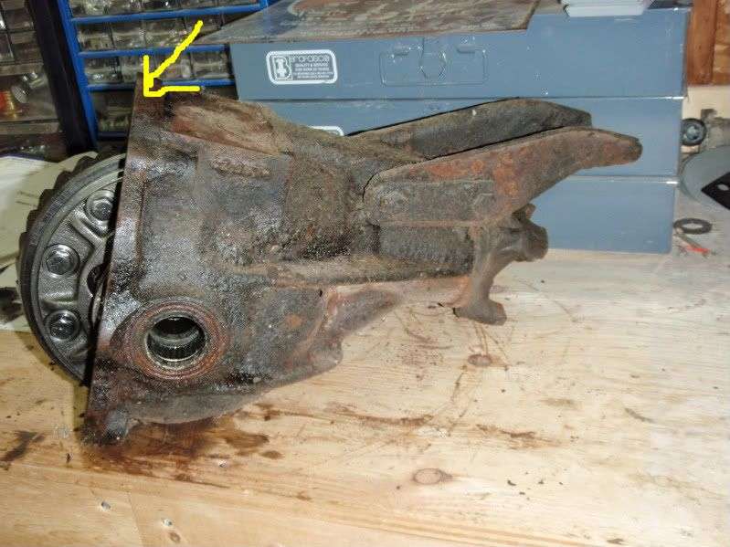

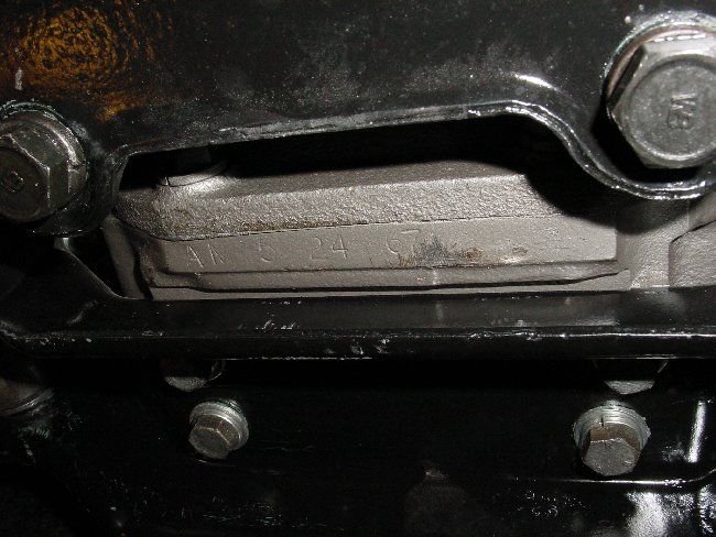

They are on the case flange where mating surface between the case adn cover are on the bottom. You may need to wipe off the paint or rust and crud to read them.

upside down
looking up from the bottom
