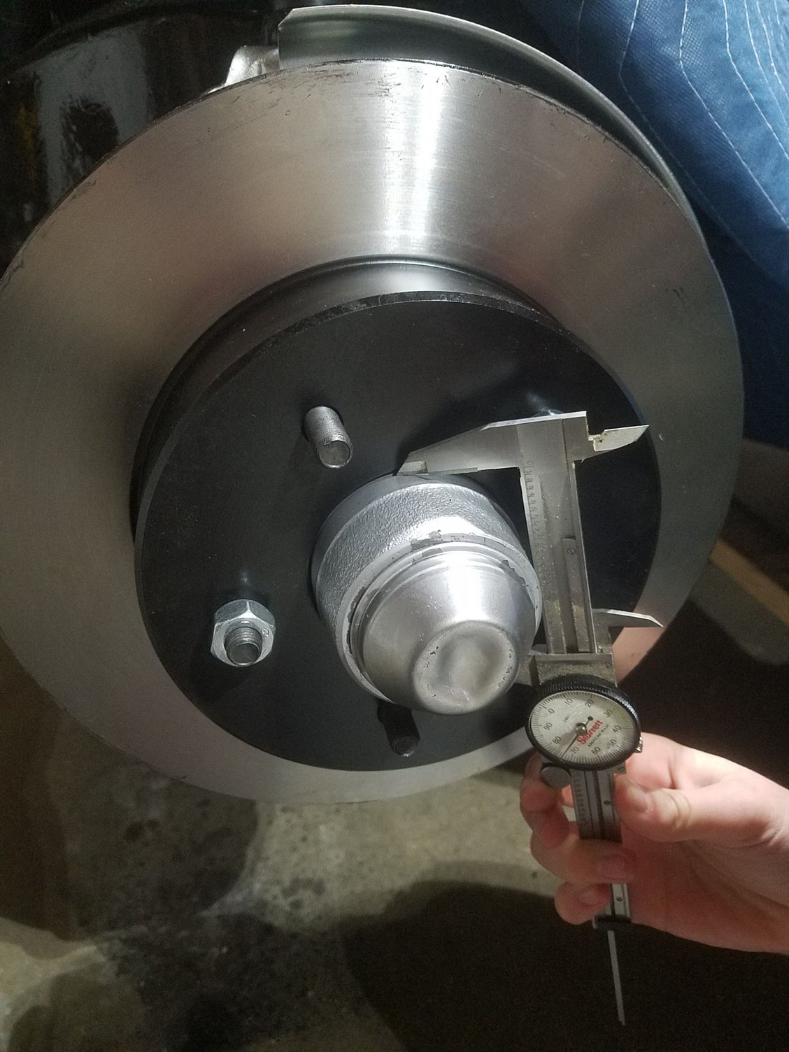

Can someone measure the outside diameter of the hub at the point where it fits into the wheel's central bore? I have a hub that won't fit and want to find out if it is too large or if the wheel's hub bore is too small. The measurement I made is 2.775" OD on the hub; the wheel's ID is 2.765! Any help would be most appreciated!

2.773"

Got it! Thanks very much!

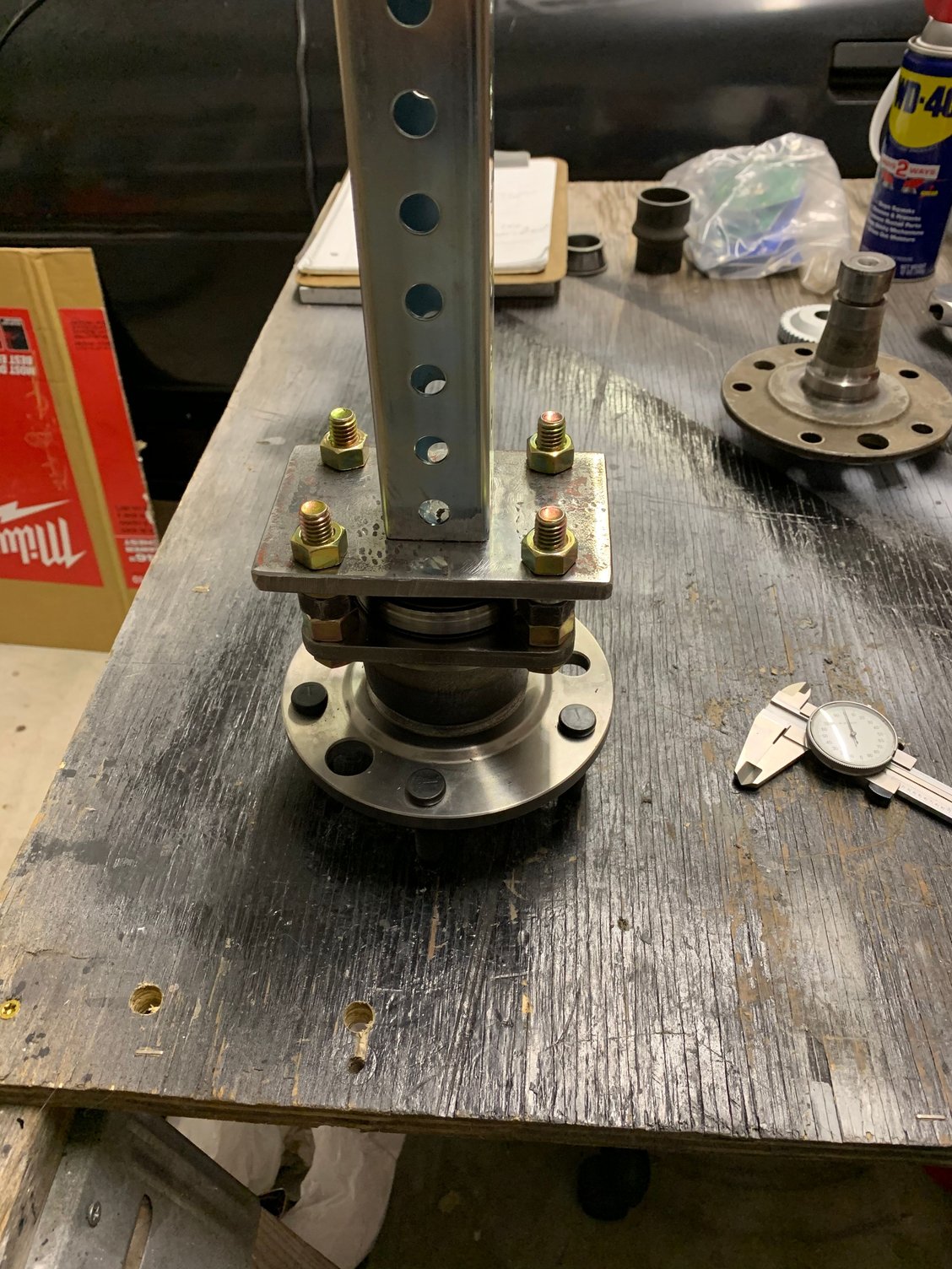

Gusto, the hub is for a bench test device I'm building to be able to mount Corvette rims and check for runout. With the oft-reported problems with the C7 GS and Z06 rims, I thought it would be good to test these before mounting on the car. However, the later rims have a 70.3 mm central bore, but the pre-C4 hubs apparently are 70.6 mm (2.775") so this is a flaw in my plan. Now, it's either turn 10 thousandths off this C3 hub or use a later hub/bearing assembly.

I switched to a corvette hub from a C4. Here are a few pictures.
Hub attached to plate
Ready to weld
Welding complete
Plugged into engine stand
Dial indicator

I should have added that the slightly smaller diameter of the C4 hub (~.01”) means that this tool would work well for the early vette wheels as well.
