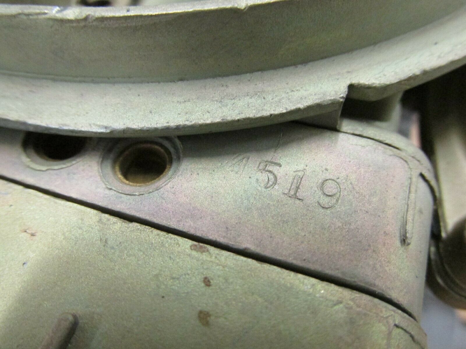

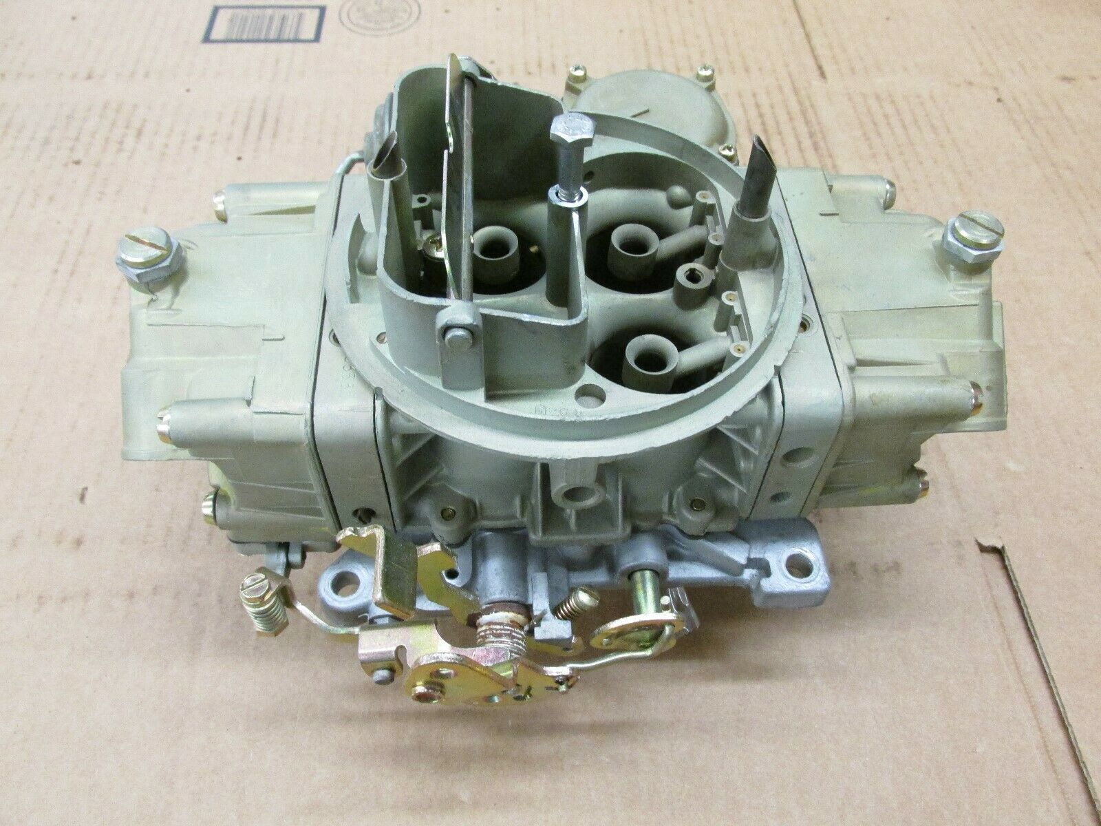

For the Carb be careful of people selling a 4 digit date code as original as the are not. It is not just the carb center housing numbers also the primary bowl # stamped 6333 secondary 4519 look for any indication of grind out and re-stamp which is done a lot on the 4555 number
The numbers on the 4555 should look very close to this. The date normally is 4 to 6 weeks before cars production. Plus other photos also notice the clutch screws in the accelerator pump these are correct.

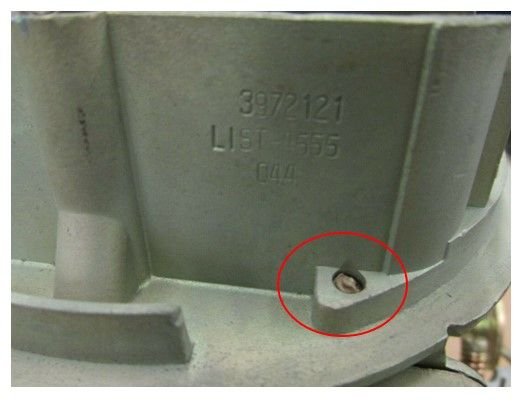

This photo also shows a little known fact about LT1 carbs. There is a piece of "putty" here covering a very small brass needle screw with a round nose which is actually an adjustable idle air bleed for emissions adjustments. Only OEM factory installed carbs had them. The later service counter carbs did not. This is another way you could spot a possible "fake" carb. They might fake the date, but never the air bleed. Not many people know to look for this. Dunking the carb ruins the putty, and then it looks like this one. Factory ones are so smooth here you almost could be convinced it is a metal divot. So just look at the outside air bleed inside the choke horn, directly opposite this screw, it has a huge orifice on these carbs, not a wire drill size like all the others, because it is no longer the tuning restriction, the screw is. Mine gave me so much fits tuning it I sent it back to Holley in the early 1980s and they rebuilt it and had to look this up on the factory blueprints and even back then the Holley tech was very surprised at this unusual feature. Tip: If you can not get your carb to run right, and your right & left side to run consistent AFRs & temps, at idle to cruise, look here and see if one of these "moved" like mine did. PITA!!!
