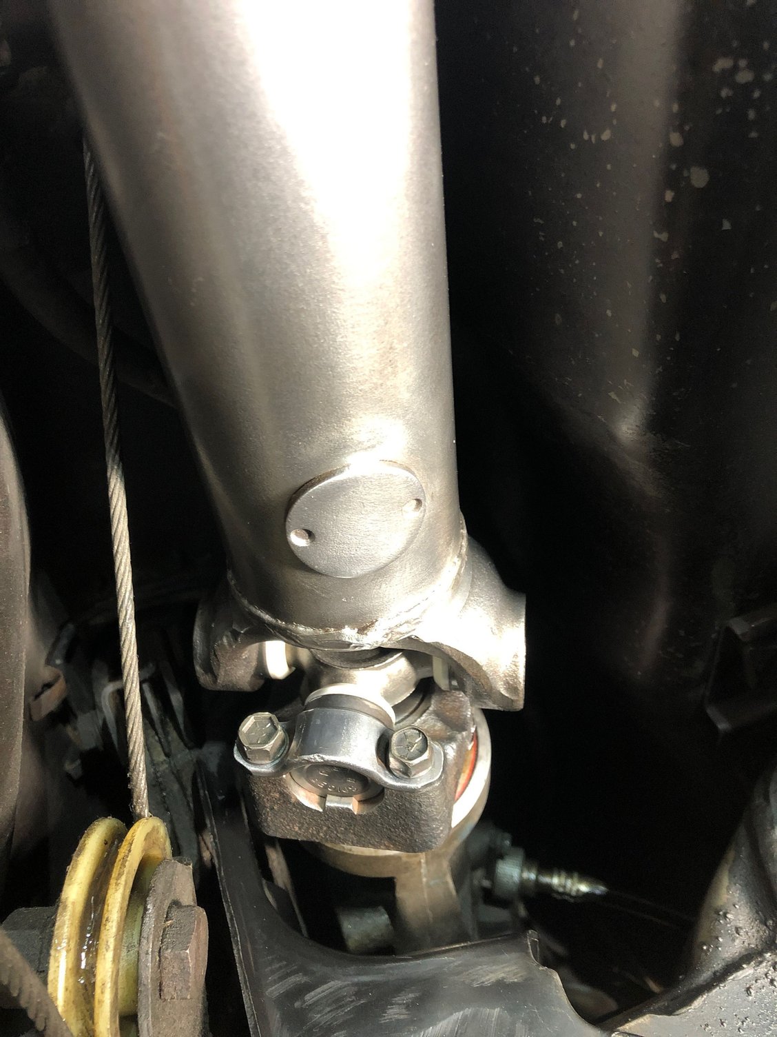

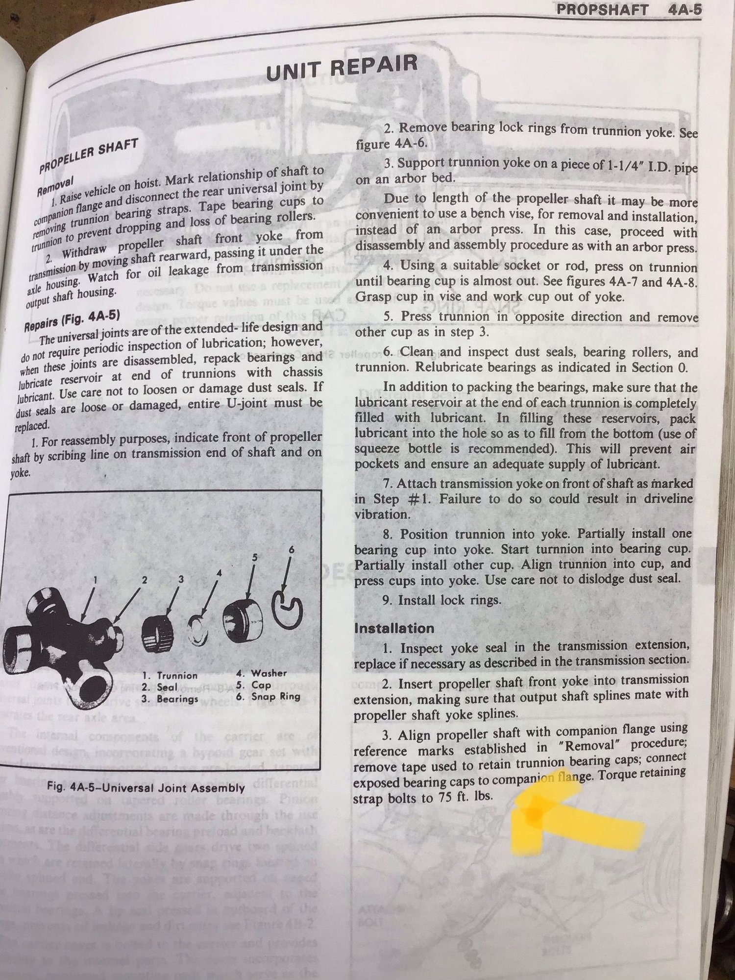

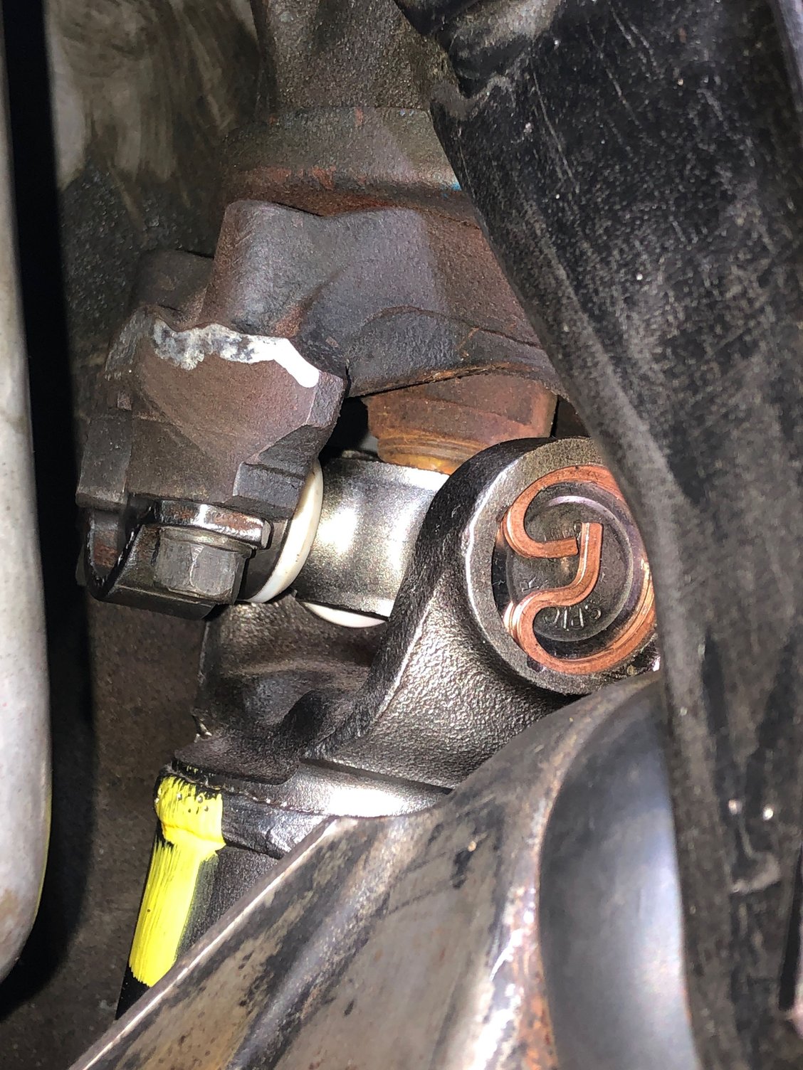

Hi,
My oem manual says 75 foot pounds for u joint retainer bolts..no way must be misprint and see one post about it..there also seems to be a range of recommendations from 115 nch pounds to 30 foot pounds...
i went 15 foot pounds and a hair extra..will that be ok?

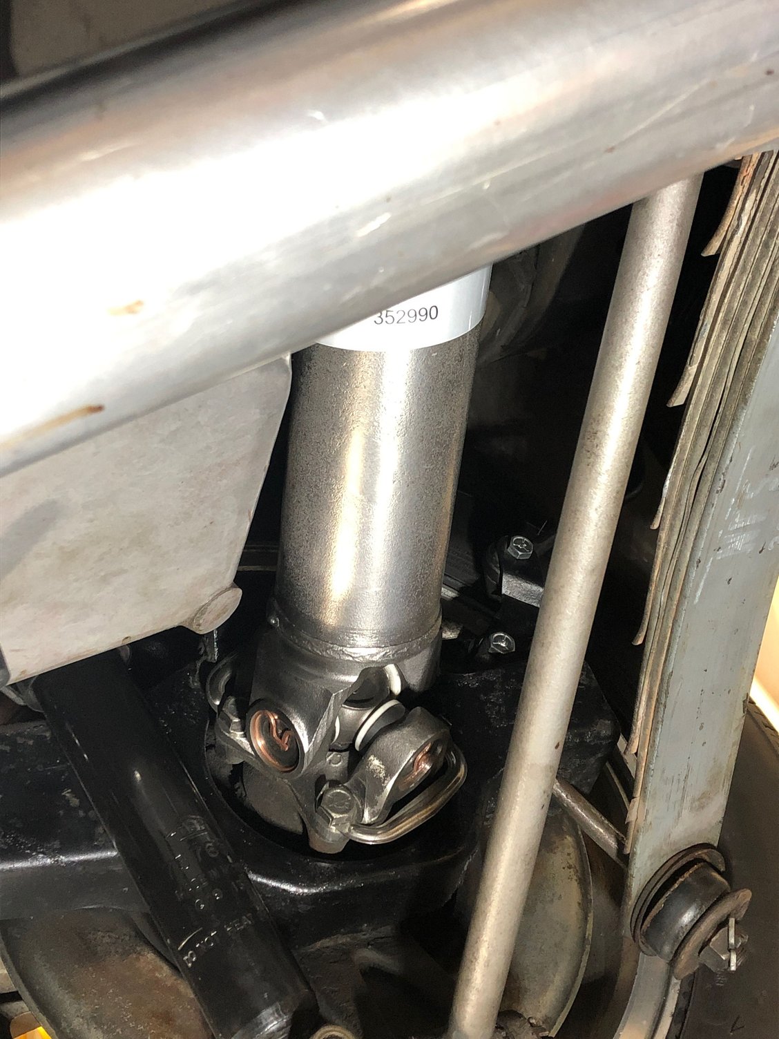

Half shaft labels ..i am getting driveshaft labels too 3921675 was the number i had
7/16 bolts 15 plus foot pounds
Clear over steel
Before
After
Before
After

Looked in the 69 manual.
70 ft/lbs is the half shaft to the axle spindle.
U joint caps are 15 ft/lbs.
thank you sir..off the jacks!

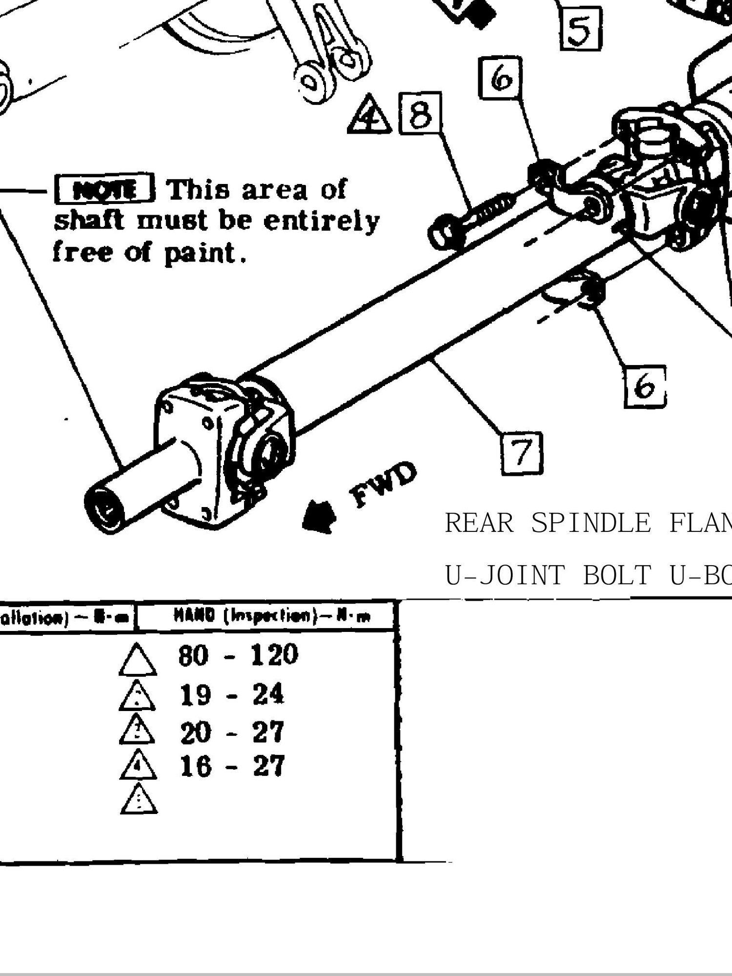

here is manual i have for 79

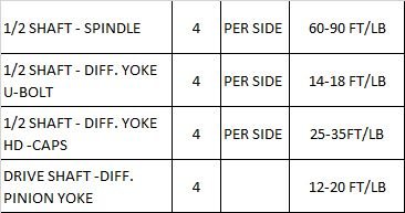

72 AIM Values

72 AIM Values
M
forgot about aim...thank you..very similiar
~12-20 ft pounds converted
thank you again
