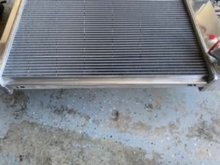

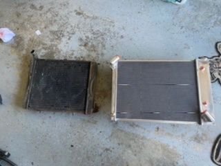

I ordered a Champion Radiator from Jegs and it said it was for a ‘68. As you can see from the pictures, its for this ‘68.
Dimensions will fit and I like the idea of the bigger radiator. Should I make it work or send it back and get a smaller one?

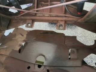

The stock radiator has studs on the bottom that line up with the holes in the car but the new one has nothing. Is there any way to make this work?

are you sure you dont have a 68 no air manual??? or you chose one with AC and yours is not ?
look here..68 w ac shows no **** on bottom
https://www.zip-corvette.com/68-82-c...odel_year=1587
here is USA made
https://www.zip-corvette.com/63-67-3...-radiator.html
Champion does not make a radiator for your application. What you bought is the Auto transmission radiator. https://www.championradiators.com/Ch...ator-1966-1968
You car has the manual transmission aluminum factory radiator.

Your original radiator is the small unit for base cars (no AC, manual trans, etc). It is pared with the steel shroud. You purchased the larger radiator that came equipped with ac and auto cars. It is pared with a larger fiberglass shroud.
you can use the larger radiator but you should ideally install the larger fiberglass shroud to match it.
