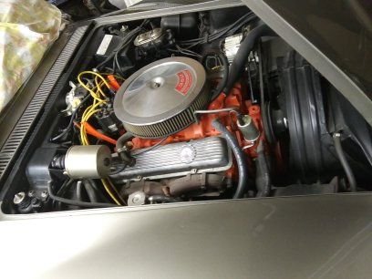

Originally Posted by PJO
Your covers have textured look to them. Here are what new NOS correct covers looked like installed but have not had the engine run. As you can see they have a minimal reflective look to them.
is this a 1969 350/350? I need complete and factory correct photos of the engine. If you have these, can you please forward them to me?

The engine shown in the post before this one is an LT1.
This is my 1971 LT-1 when I have some time will check my photo files.

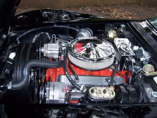

Here is a friends 350/350 it is a NCRS top flight and Duntov plus a Bloomington Gold. I can get more photos if needed.

Thank you so much. I didn’t want to trust the google image gamble. Did all the 69’s have the chrome distributor cover?

Yes they did. This car is a triple black convertible side pipe car. She also has a 350/350 Black coupe side pipe with red leather interior very rare.

Just a small clarification- the only '69's that did not have the distributor shields were the L88 and ZL1 since they could not be ordered with a radio.

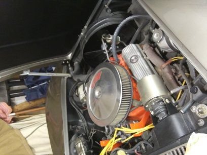

Default ​​​​​​​Early with metal shroud.
Bremquest;
Here's a couple of pix of my EARLY 69 L-46. This car was all 'performance' no gimmicks. No PS, No PB, Radio Delete, M-21. 36k miles. Distributor covers removed and etc....was autocrossed a bit back in the day.
Hope this helps.

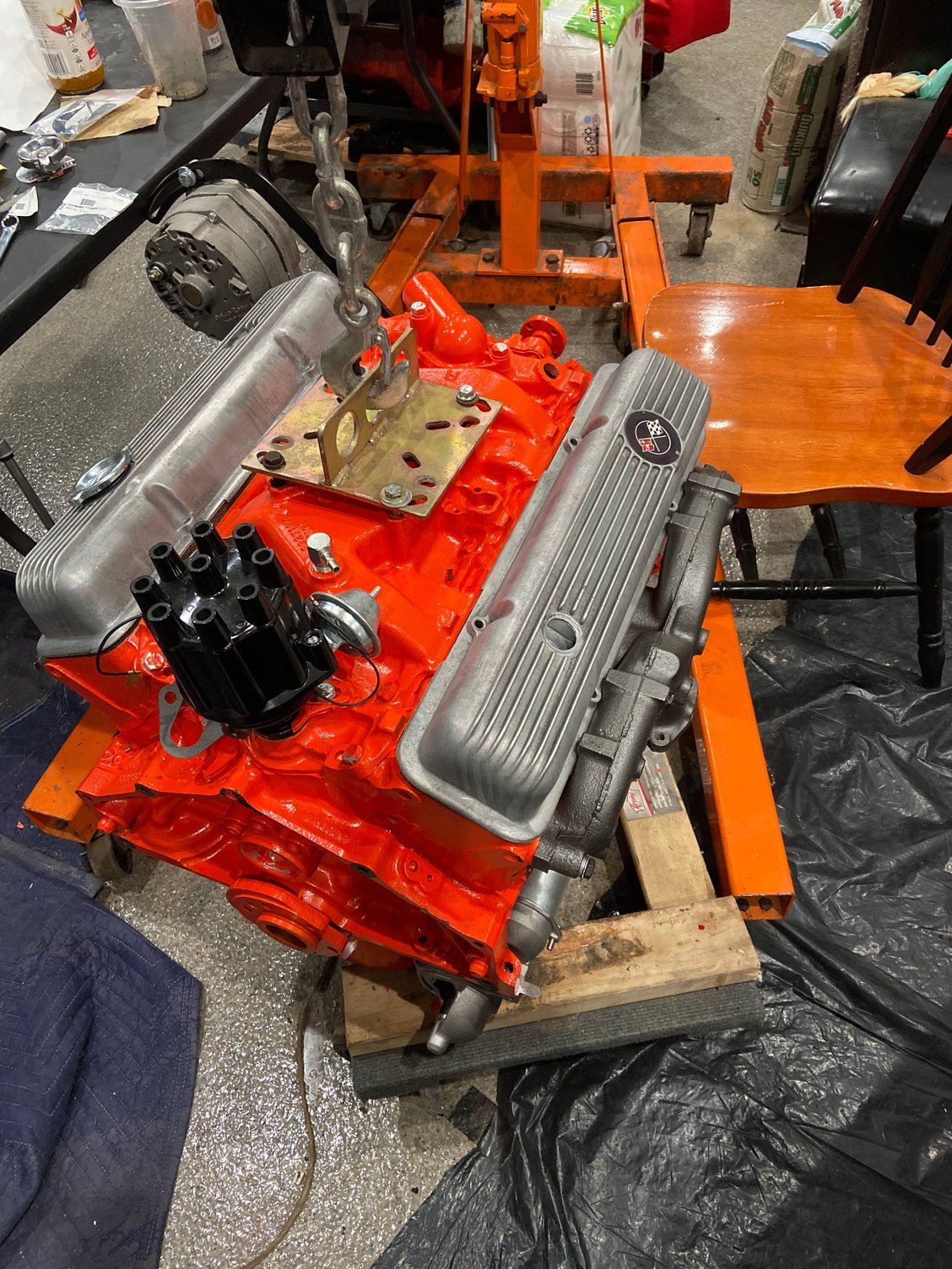

ok,I found these (and purchased) on marketplace for $100, came off a 69 in someones garage that they are selling off due to a death. The owner had replaced the covers with after market and these were on the shelf. 3" cutouts but not the correct oil cap. What do you guys think? I feel like the notches are longer than the photos in this thread

Good find. Measure them as it is hard to tell from the pics. Also, the oil cap looks ok, but again hard to tell from pics.

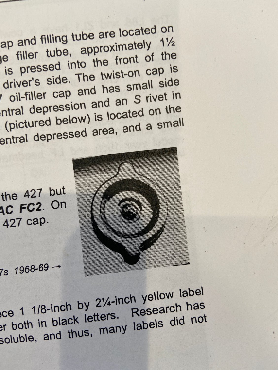

The oil cap that was on there was close but no "S" rivet. the relief cutouts were correct size I believe but those notches where you bolt the cover on look longer? Either way its better than those cheapies that were on there

I would look at mine for you, but sleeping for the winter. I have a few chrome S river oil caps, there are several versions.

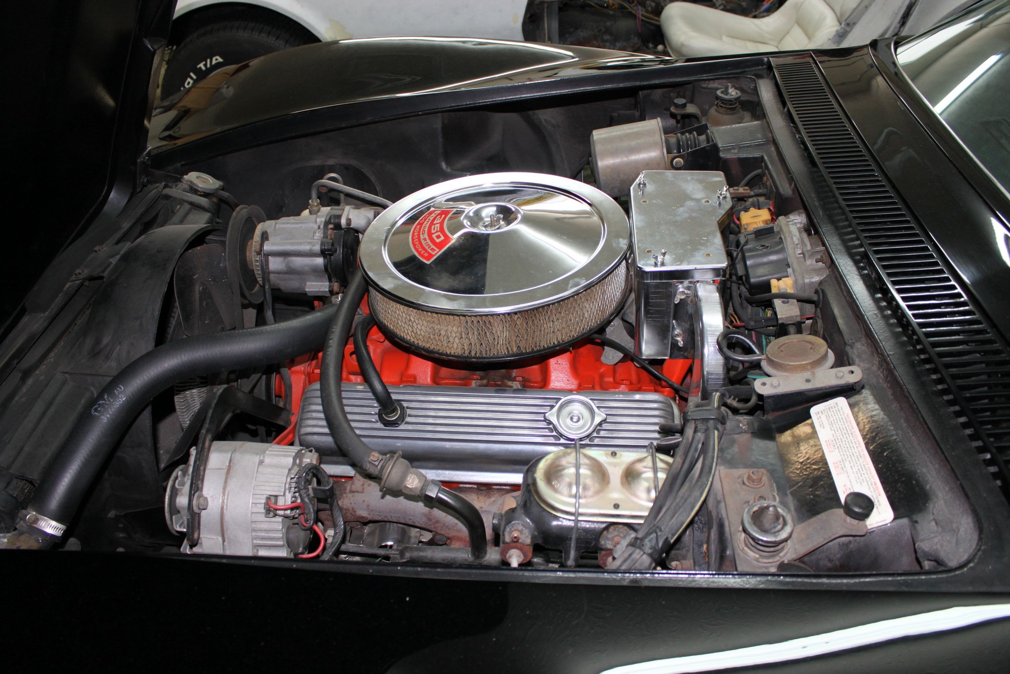

Another pic for general reference. Not judged.

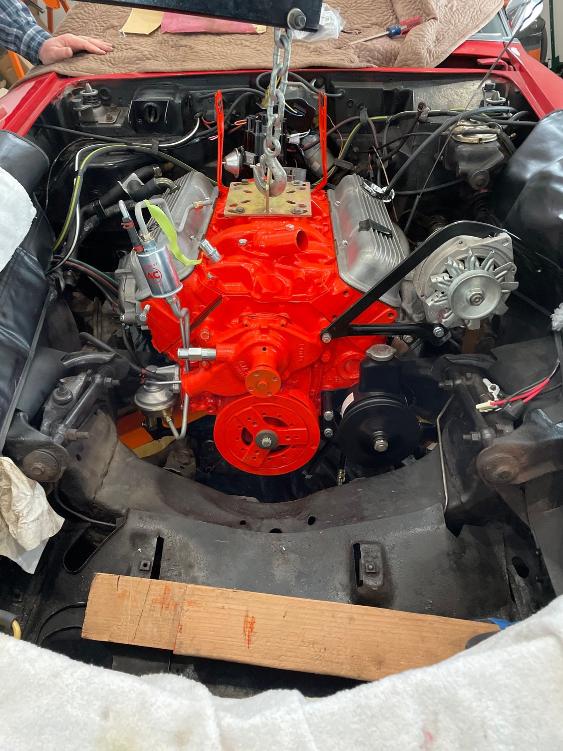

Update on the project. Engine went in today
