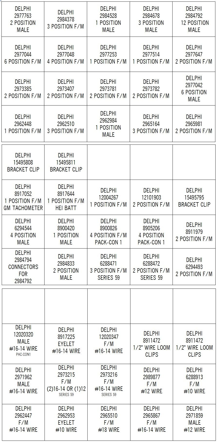

Unfortunately, using the Willcox Corvette Line Diagram (Tracer Schematic) there are no part numbers on the connectors like later years provided. I can provide you a list of what I have gathered overtime for my 77. I have 3 separate organizers that's why 3 blocks of numbers. Many of these may be the same as what your 69 uses.
If you type the part number into the Part# Key Word search bar at top of page Not always, but most times it will also provide a photo.
MOUSER LINK:https://www.mouser.com/Connectors/Automotive-Connectors/_/N-1ehb5
Example of #2977763 2 position Male Housing first part number provide above LINK: https://www.mouser.com/ProductDetail...cCYLBg0g%3D%3D
I NEVER said this would be easy
Good Luck!

That's a huge help, thanks!
