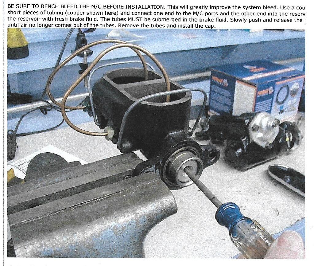

Yes! bench bleeding the master cylinder is needed and easy.
Here's how:

Also just a little note here:
WARNING- WARNING- WARNING ! (Ok a big note)
Do Not Force MC Piston in more than 1 3/8"
or you will damage the seals, void the warranty.
For tips & photos, click on my profile, then photo albums, pressure bleeding.

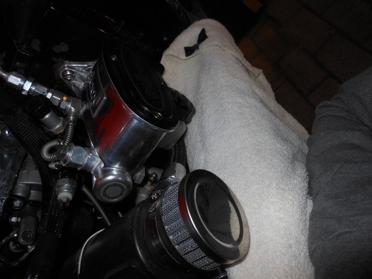

If you have a completely empty system you DO NOT need to bench bleed the M/C!!!
Bench bleeding keeps from putting air into the lines- if the lines are empty- it doesn't matter.
Plus you will not be dripping brake fluid all over trying to install one with fluid in it.
FIRST
I have a cheapy vacuum pump- I connected it to the front line off the MC first- and made sure it would hold a vacuum before finding brake fluid leaks.
Was able to pull up to almost 25 in/hg and it held for 10 - 15 minutes
Then did the same with the rear line.
Also went around to each bleeder valve when it was holding a vacuum and opened the valve- I head a hiss- and it was good to go!!!
Here is a GREAT video- did exactly how he did it and I had a completely bled brakes in about an hour or so.
Made up a vacuum can out of a mason jar- my wife will never miss it!!!
I also put grease on the threads of the bleeder valves to stop and leaks while I was bleeding.

I disagree. The master does not care if the brakelines, calipers are full of fluid or not. The master does care if bubbles are trapped inside the piston bores.
The tilting of the MC while forcing the piston on a bench is a whole lot easier than jacking up the car to tilt the MC. Takes just a few minutes to remove MC and put it in a vise.
Did you watch the video?
I've done a lot of brakes in my day-However- that guy does it for a living....
Taking my Master Cylinder in and out takes way more than a couple minutes- and it's polished - definitely didn't wanna put it in a vice nor spill brake fluid on my detailed engine compartment.
I have always heard to "Bench bleed"- so I did a little research- and it is really not needed using this guy's system - I filled up the Master and used a vacuum pump to pull the fluid...
Like I said- an hour later I had a completely bled the system- AND I followed fellow forum member "ignatz" to unbolt the rear caliper to raise the bleeder valve above the piston.
https://www.corvetteforum.com/forums...ar-brakes.html

Richard, you are talking a whole different ball game. Wilwood MC with bleeders and Wilwood calipers with bleeders at different angles.
No comparison to GM brake system.
A C3 master cylinder can be removed from the booster in two minutes flat. Two mounting nuts, two brake lines.
Nice pictures though.
