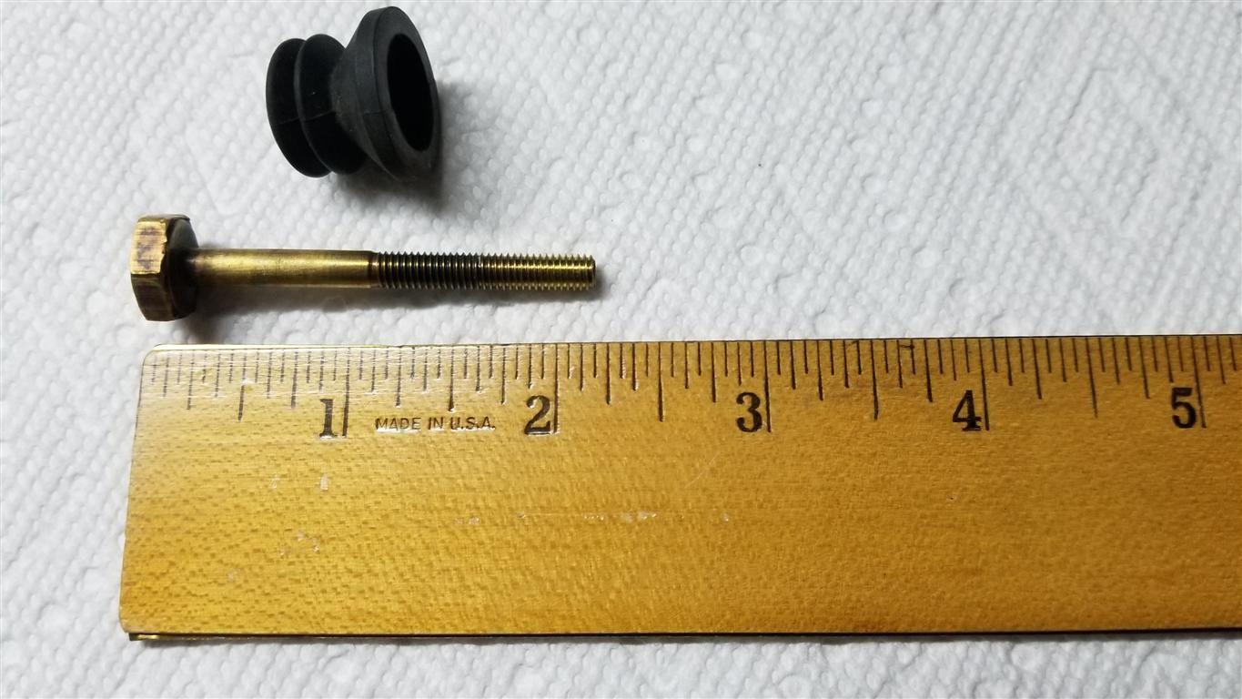

The replacement Idle Stop Solenoids may have a shorter adjustment screw and housing but they should still work.
The 17061769 has an adjustable stem for dialing in the idle speed when solenoid is energized.
The 17061769 Solenoid and attaching hardware:
Adjustable Stem:
