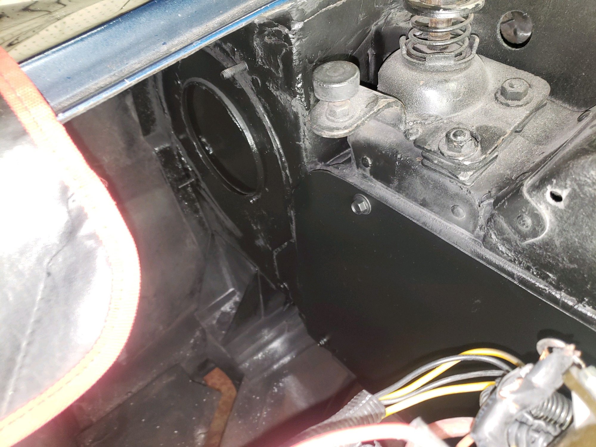

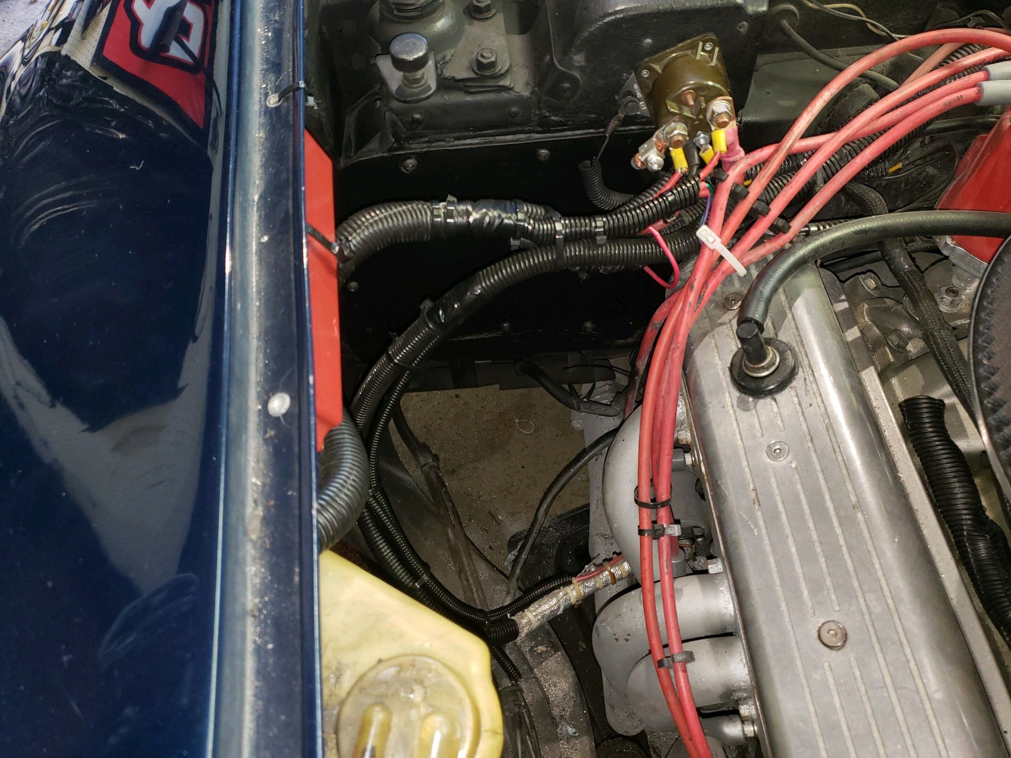

Years ago when I swapped out my L48 I left that ugly box on the passenger side of the motor that houses the AC lines and heater core..
I got around to removing it over the weekend..That and the charcoal canister I took out on the drivers side weighed in at 45 pounds between the both of them....A buddy of mine removed the charcoal canister and it was weighed down with a bunch of crap ....It was on the car since it left the showroom..

Fiinished product...Well, sort of..Have to touch up my headers with high temp paint and take a buffing wheel to the valve covers.....Over 40 pounds of unwanted weight gone...Plus another 35 w composite spring....Car is level on both sides in back and ride is still very good..
