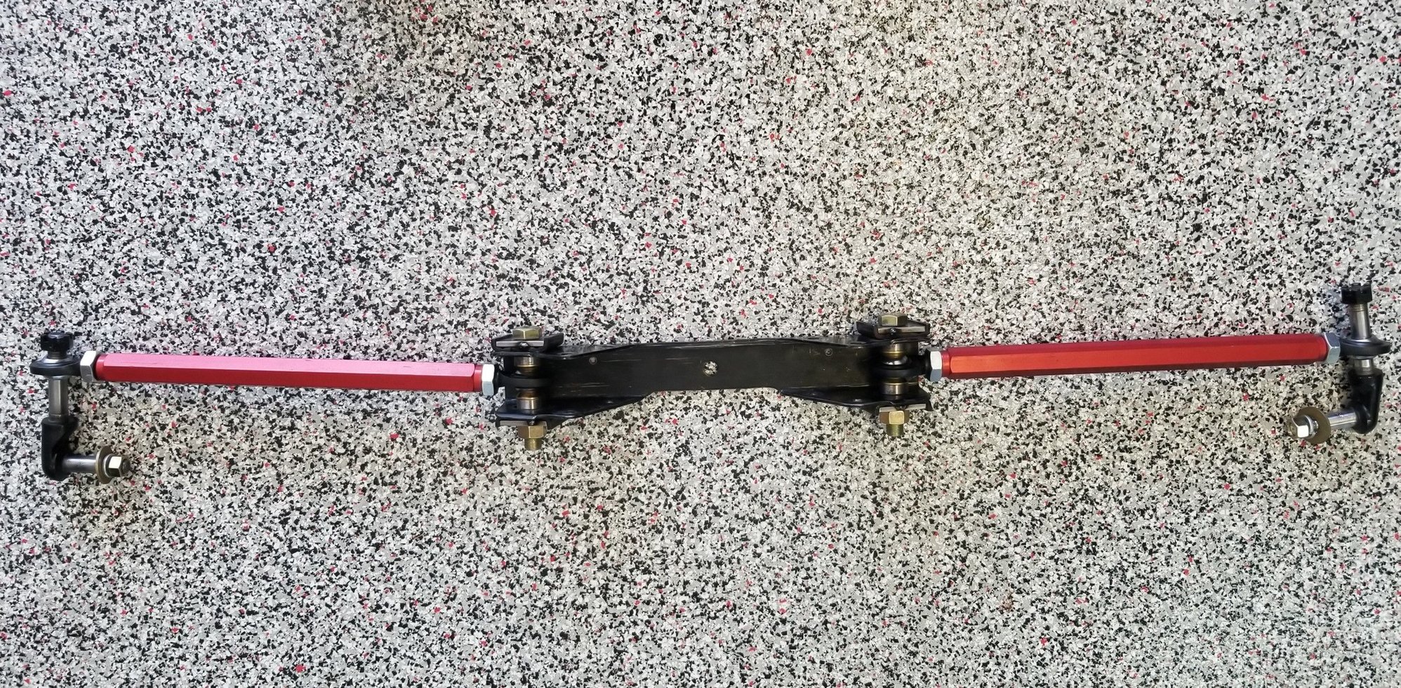

Old Dec 8, 2020 | 09:58 AM
eddp's Avatar
eddp
Joined: Jun 2019
Posts: 232
Likes: 14
Default Who makes those?
Originally Posted by reno stallion
Who makes those struts? Or, can you buy the heim joints and attach to any adjustable strut?
I believe these are Van Steel
