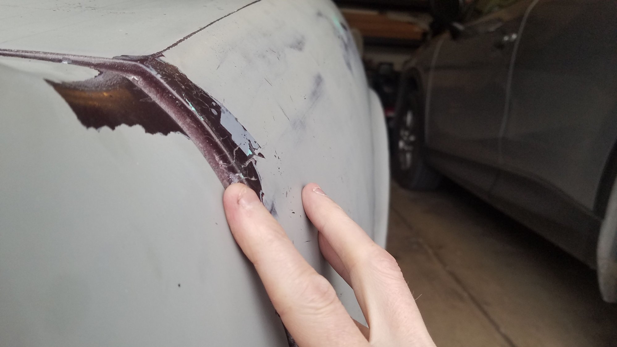

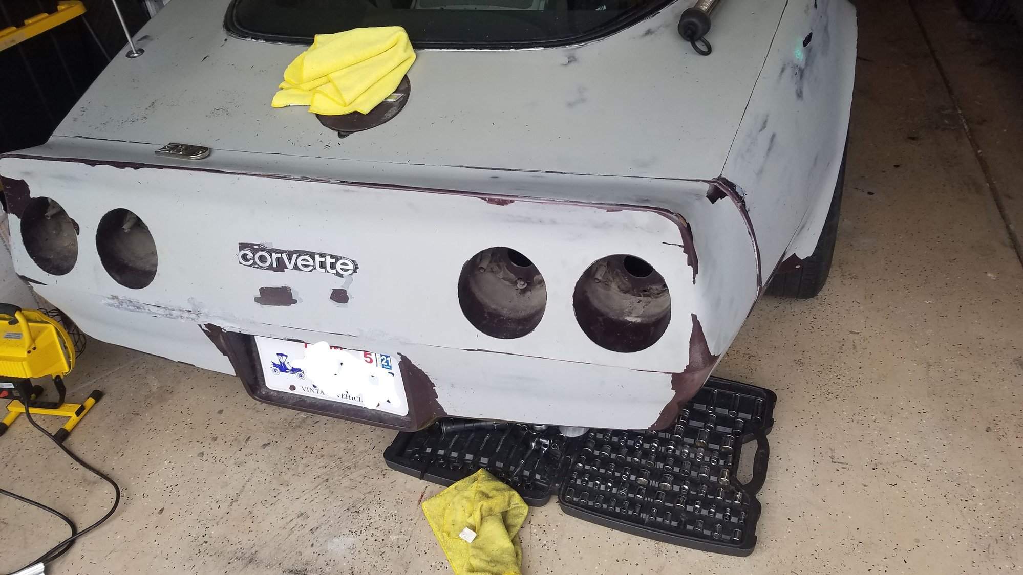

I appreciate everyone's input. I started to take the rear bumper cover loose and am finding that it's going to be a serious pain in the butt to get all the bolts out. One already broke off on the side as i was trying to get the nut off. I'm sure I'll probably end up having to replace all the mounting hardware. I had a body shop take a look at my car a couple months ago, just for an initial quote, and they said the rear bumper has probably been replaced, based on the fact that it doesn't line up worth crap on the passenger side. You can see in the pics the offset vs the thickness of my finger. The driver's side lines up perfect. It also appears to be a urethane bumper, not rubber. I don't know if the original would have been rubber or urethane.
Is it possible to build up a urethane bumper so it fits the car better, or is it a lost cause? Other than the passenger side fitment, it has a little work that needs to be done to the left of the license plate. You can see it in the pics. I always struggle replacing parts that don't necessarily need to be replaced. Especially if a body shop is going to have to do the work to fit a new bumper anyway. Why not just use what i have?

I would highly recommend you not waste time and effort trying to salvage an original or even a replacement urethane bumper that is more than 10 years old. I do not believe you will be happy with the results. Urethane bumpers become more brittle with each passing year. The use of solvents on them in the painting process also adds age to the urethane. If you plan to use a urethane bumper, start with a new, quality bumper and you will be much happier over the long run.
If you are planning to flip the car soon, well that's a different story...
Good luck... GUSTO
