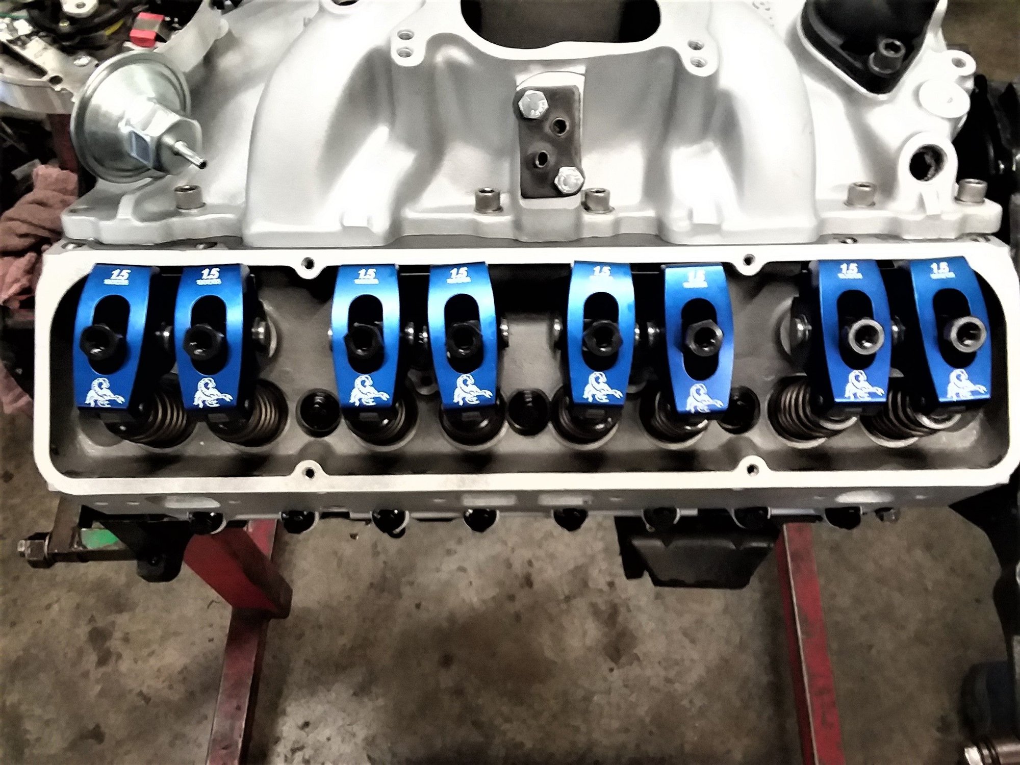

I used a variety of rockers and valve covers. I bought aluminum spacers and painted them orange to match the block and raised the valve covers for extra clearance. When you buy your rockers make sure you measure the valve spring diameter so you get the correct size rocker. And you will have to remeasure the push rods to make sure they are the correct length as well. Its not common that they will fit perfectly but sometimes it does happpen. I have used Harland Sharp and Scorpian. Had very good luck with both. If you want a little extra power you should up the ratio to 1.6 if you have the valve clearance. Even with 10.5:1 domes I had plenty of clearance.

I used Scorpion, they fit under the L82 valve cover............and they look good
