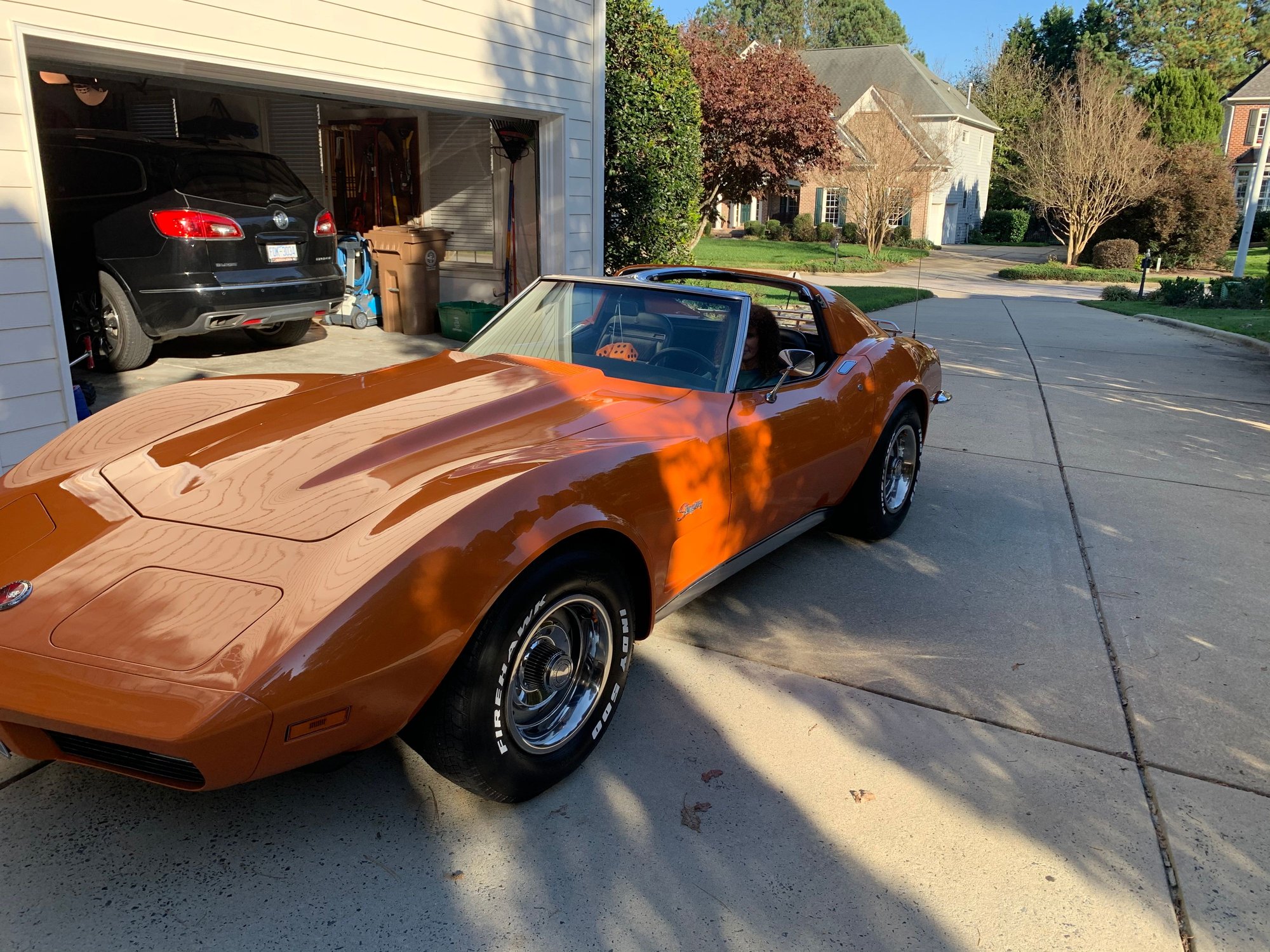

Hello friends,
I would like some opinions please. I have an original 1973 vette with 63,000 miles but it does have the 195 HP SBC. I have been in discussion of having the engine and gaining more horsepower. My restoration person says my options are limited if I want to have under the hood to look exactly the same as it does now. He said maybe 400 HP. However if I am willing to have some change in looks then he can do Vortec heads and maybe a supercharger. I have always wanted to keep the car original to hood it’s value. Do you think 500 or even 600 HP under the hood would detract from the value? Any ideas or suggestions I can bring to him on increasing HP with a rebuild? I wanted to keep the original block.
thanks Michael

Your engine compartment looks nice to an originalist like me. I'd find some good flowing heads with a small combustion chamber, leave the block alone and keep your Q-jet carburetor. Paint the heads to match the block, leave the air cleaner as is, forget trying to out street race all the newer 500 hp mustangs and enjoy your classic car. It will definitely retain the original under the hood look.
