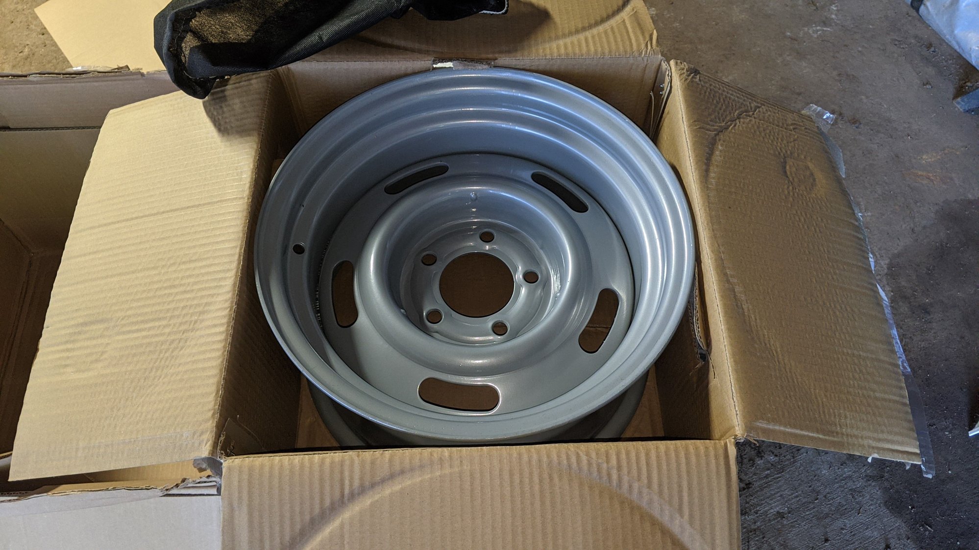

i ordered vision wheels off ebay with -6 offset and 4.25" backspacing. the same specs as the ecklers ones they advert FOR c3 corvettes. they were really discounted, $240 shipped for 4
then i ordered a trim ring and center cap package from ecklers for $260 with the GM licensed derby caps

So if you don't like the look, you can add a 1/4" spacer and then they should fit just like OEM ones.

Im 95% sure this is the offset my vision wheels have and I did use the 1/4" spacers with the appropriate lug nuts for them. no issues in the 3 or so years ive had them on the car. I have these although I dont remember the backspacing exactly. https://www.ebay.com/itm/4-Vision-14...gAAOSwzcdfm6yd
