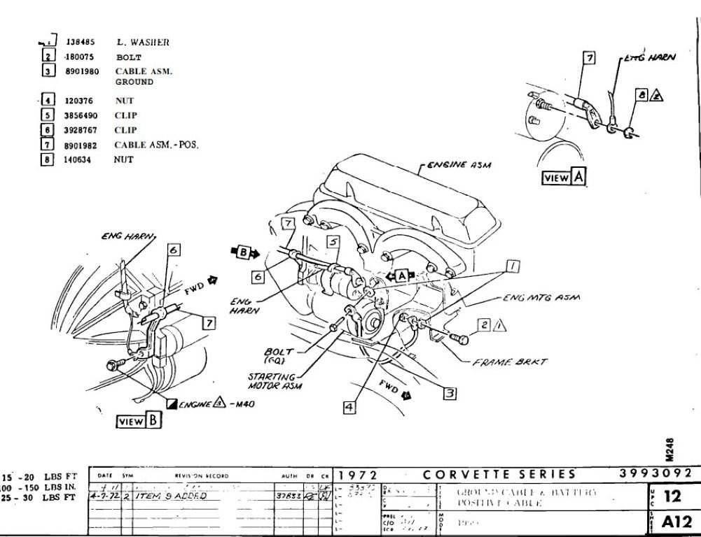

Can't get the blower motor or wipers to work in my '73 C3. Tested most of the systems: all switches are good, relays are new, motors work, fuse is good. I read on this forum that grounding is common to both and can be easily messed up. Went under the car today and saw a large ring terminal on the bell housing with a wire stub coming out of it (see pic)
Disconnected ring terminal on bottom of engine near starter. Is this where the blower motor and wipers should be grounding to?

Yes that's normally the area where they are grounded

Not sure about the 73 but on the 72 the smaller ground wire from the harness is on the bellhouse bolt that holds the main positive cable clip to the starter
Then the larger cable is the chassis to engine block connection

Thanks for the info! Today I used the ground on the alternator to ground the windshield wipers and the blower motor. Both worked! So it looks like one of the POs had the ground going to the starter.
