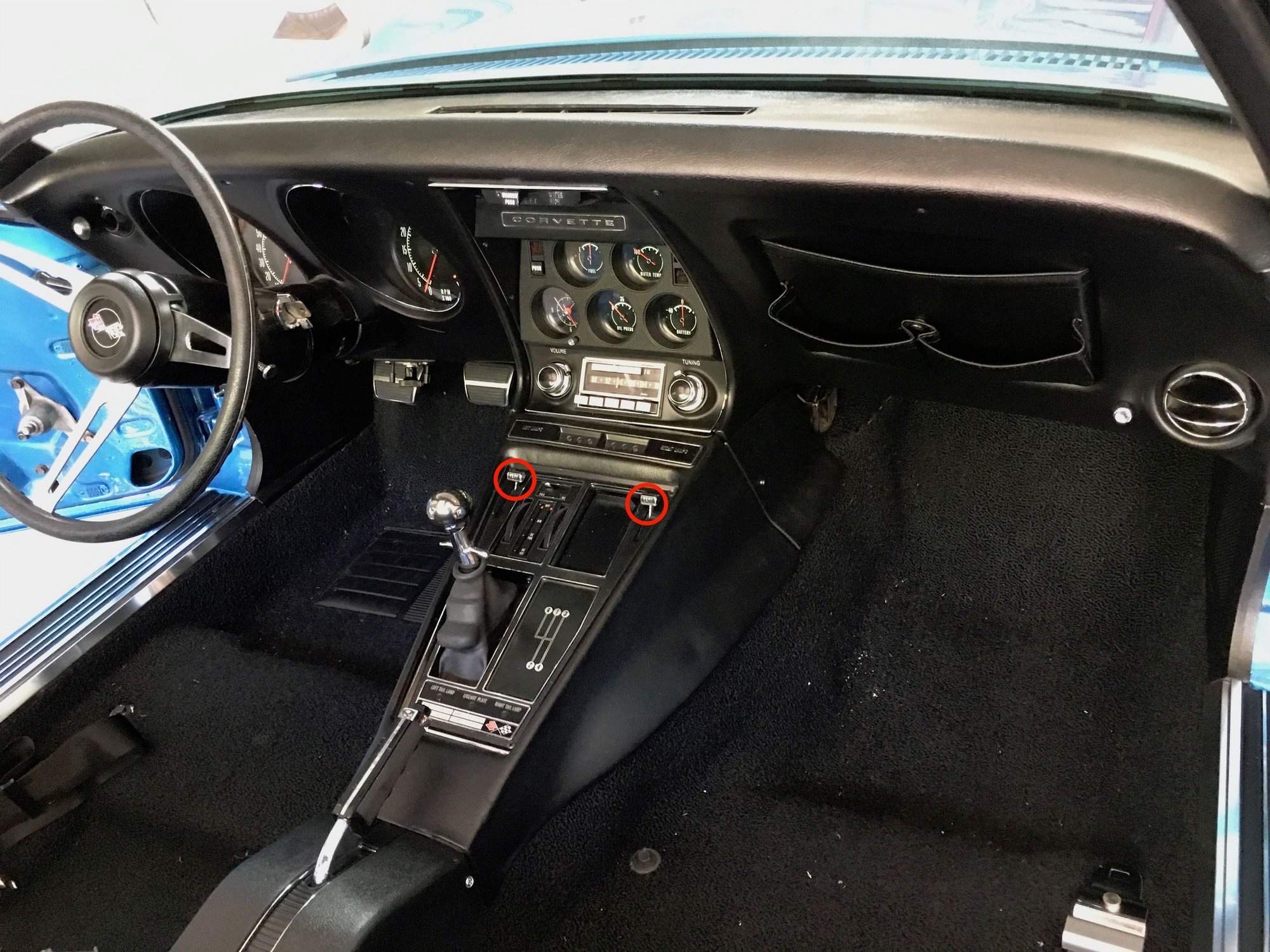

My January 16 build (#13367) came with the '68 style, chrome kick panel vent *****. I don't know when they changed over to the round ones but I've never seen another '69 that had them.

My sept 68 (69) has the rectangular ***** as shown. I have the coffee can wiper actuator also and the female belt buckles with the blue GM buttons.
They changed to the round version around VIN 14000. Also there are TWO distinct type rectangular ***** for the 69 model year. I have them on my car vin 12871.
