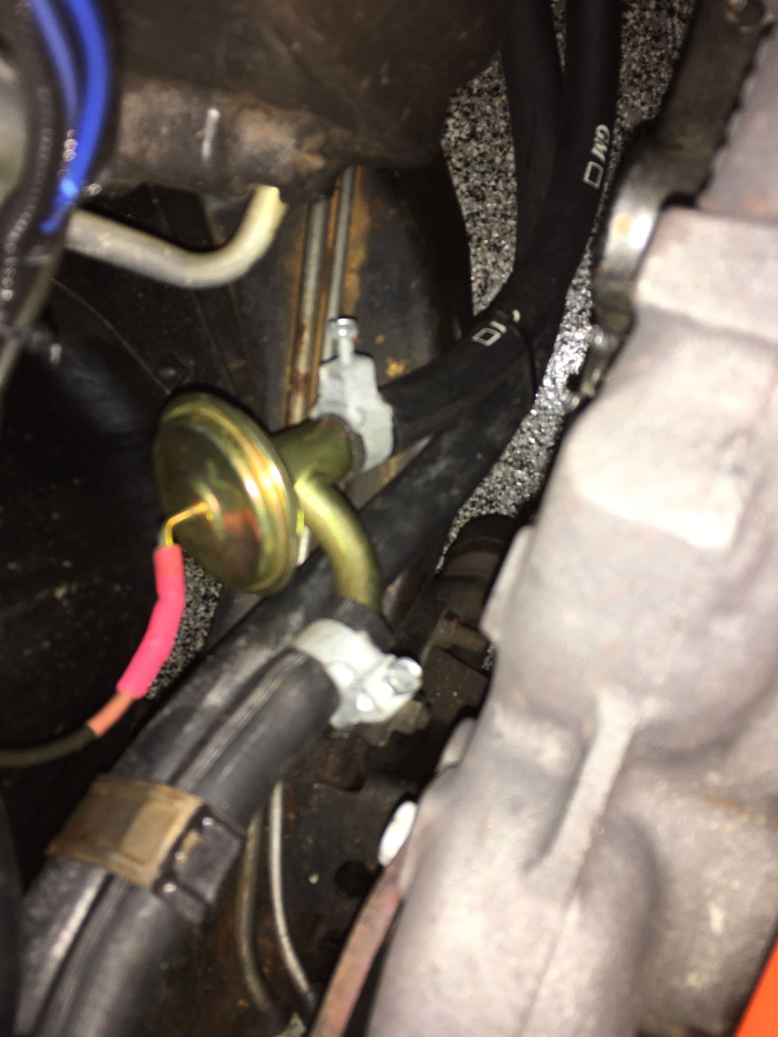

I have a 76 350 with a/c and the heater control valve on the hose coming from the engine pukes antifreeze all over the floor once I turn off the engine. Bought a new valve thinking that was the problem but it still does it. Any suggestions?

Step 1. clean everything up. get it clean and dry. start engine. let it idle and warm up. keep watching for the first drip. where is the leak??? is it coming out of the valve? is it leaking at a hose connection? once you can pin point the source of the leak. fixing it should be straight forward.

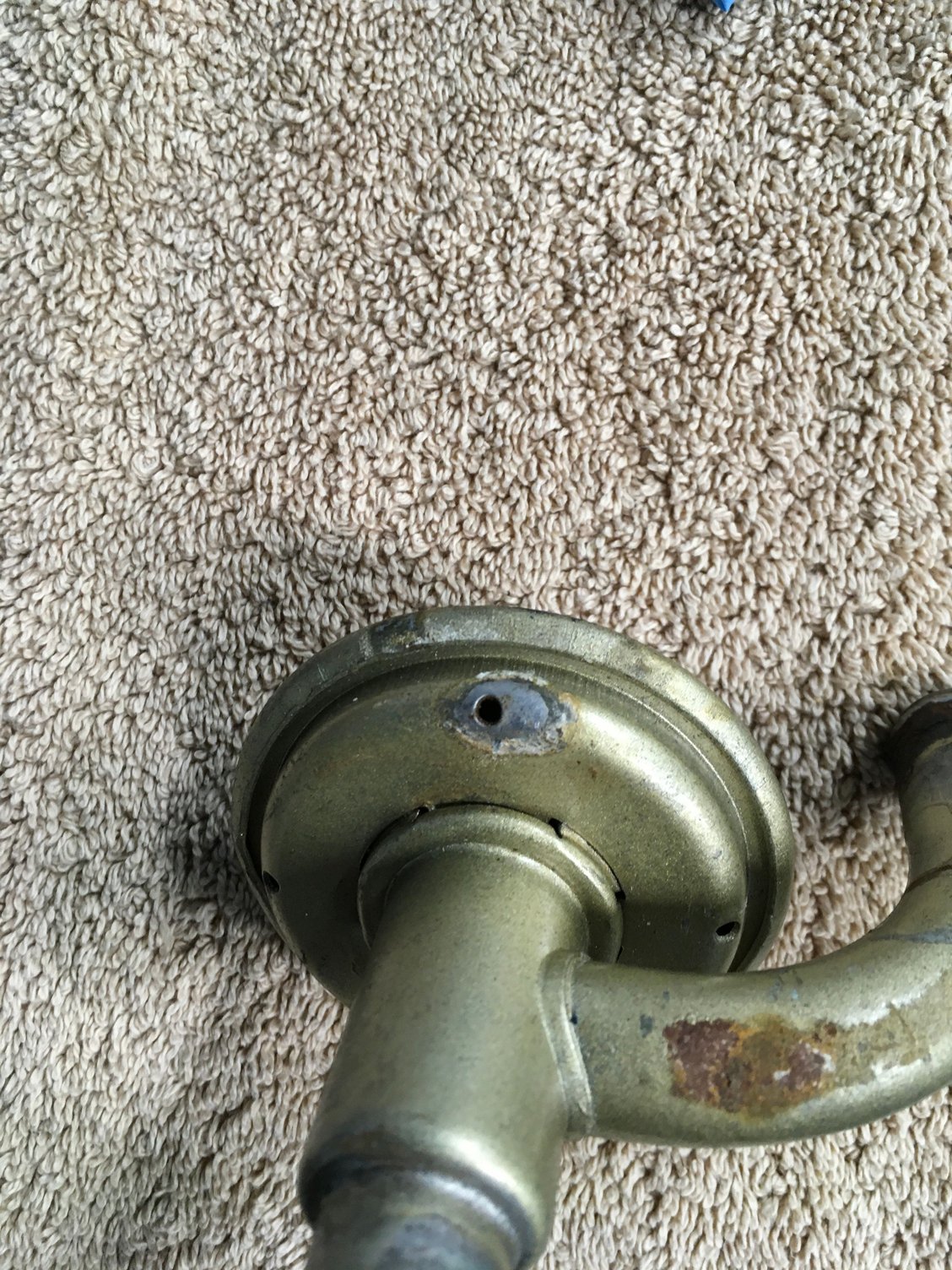

it is coming from the small hole that is in the valve itself. I thought maybe the diaphragm in the original valve had a leak the when the second one did the same thing I am stumped.

Was the second one chinesium ? Maybe you got a bad one? Those valves work very well shuttng off water

It does sound like you got a bad replacement. take it back.
