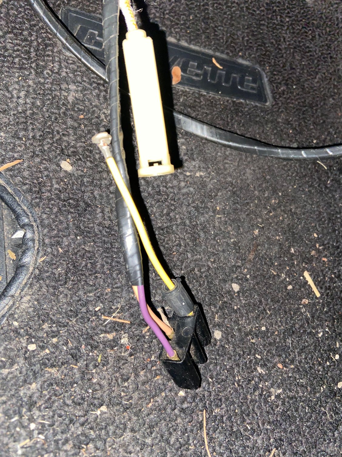

Found this tucked up in the dash (drivers side). I may just be tired but I cannot seem to locate it in the wiring diagram or asm. What’s this supposed to go to?

should be your rear defogger
Old Jan 2, 2021 | 10:05 AM
'73and'75's Avatar
'73and'75
Joined: Aug 2019
Posts: 451
Likes: 520
From: Chicago Burbs

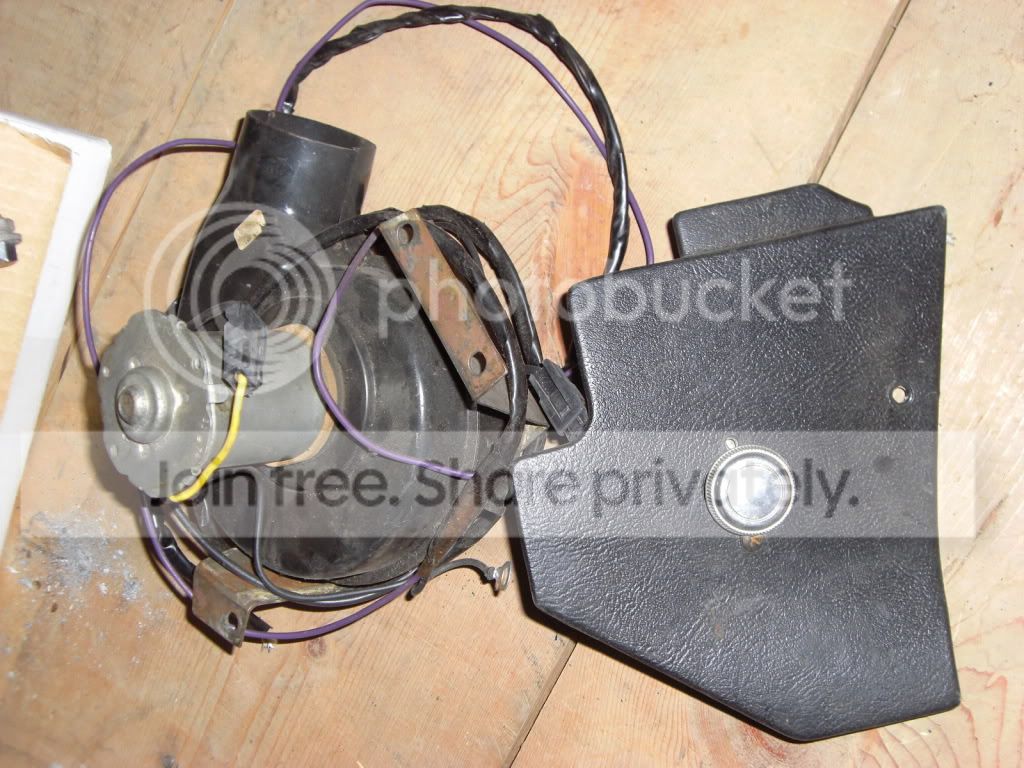

Harness is for the optional C50 Rear Window Defogger. The black plastic plug attaches to the 3 position (low-off-high) switch which is located on the driver's side forward console trim panel. The white plastic gizmo is a fuse holder. It holds the requisite 3 amp AGC fuse.
Look at the wiring diagram in your 1969 Chevrolet Service and Overhaul Manual. C50 being an option, it will have its own separate Figure (diagram).
(not my pic)

That’s right. I remember this plug from when I ran the rear wiring a number of years ago and couldn’t place it. I believe I never hooked it up due to the actual ****/switch being busted and at the time nobody made a replacement.
