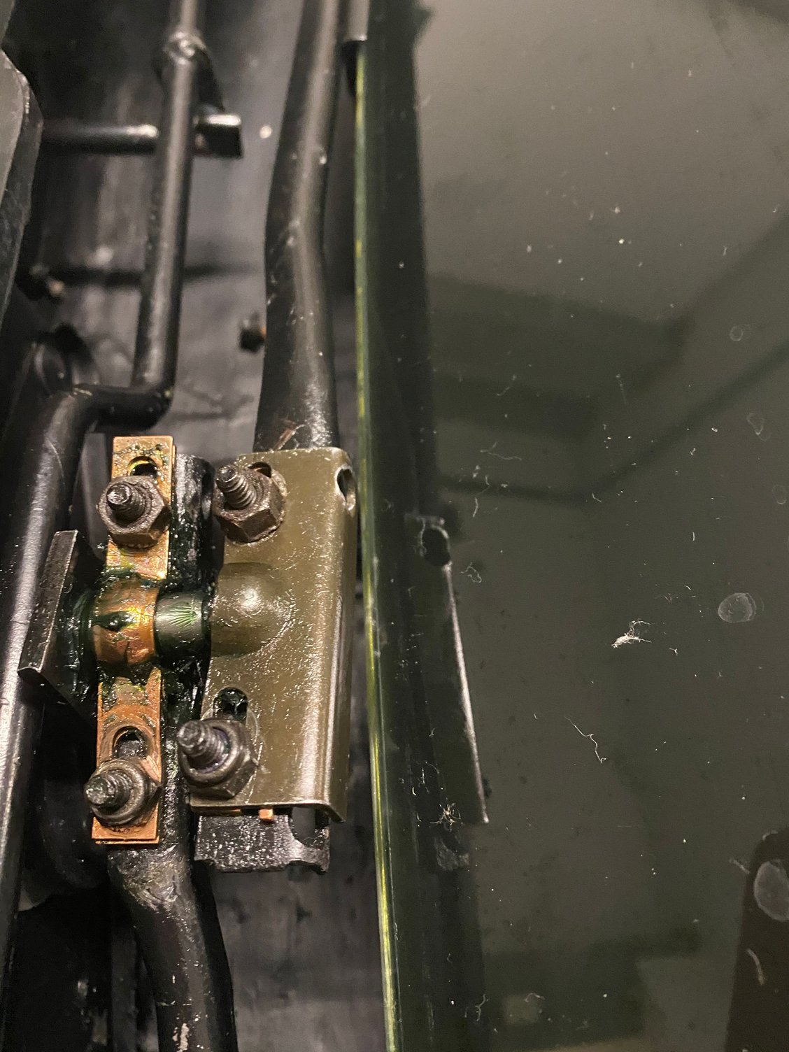

The issue is in the linkage- north and south- relative to your first picture. The bracket that goes on top has three sides and the back side is hitting the windshield.

I will take a picture.

Here is a picture of the issue.

That's strange indeed, I know the 68/69 were different but mines (72) no where near the windshield
