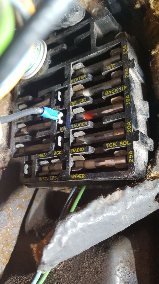

Here's a picture of fuse box. It looks like I've got the wire for the HEI plugged into the IGN, right? Again, when it cranks, power goes to 0V.

Thanks for the diagram, RIchard454!

You may have a problem with the ign switch. Check the pink wire coming out of the ign switch, should be the same circuit.

It's a brand new ignition switch but I'll check it out. Maybe I have it plugged in wrong?
Your gauges are also connected to this circuit- the pink wire. See if the gauges are dropping power on start- as they should not
Pretty tough to plug it in wrong... I'd guess the ignition switch could be at fault
