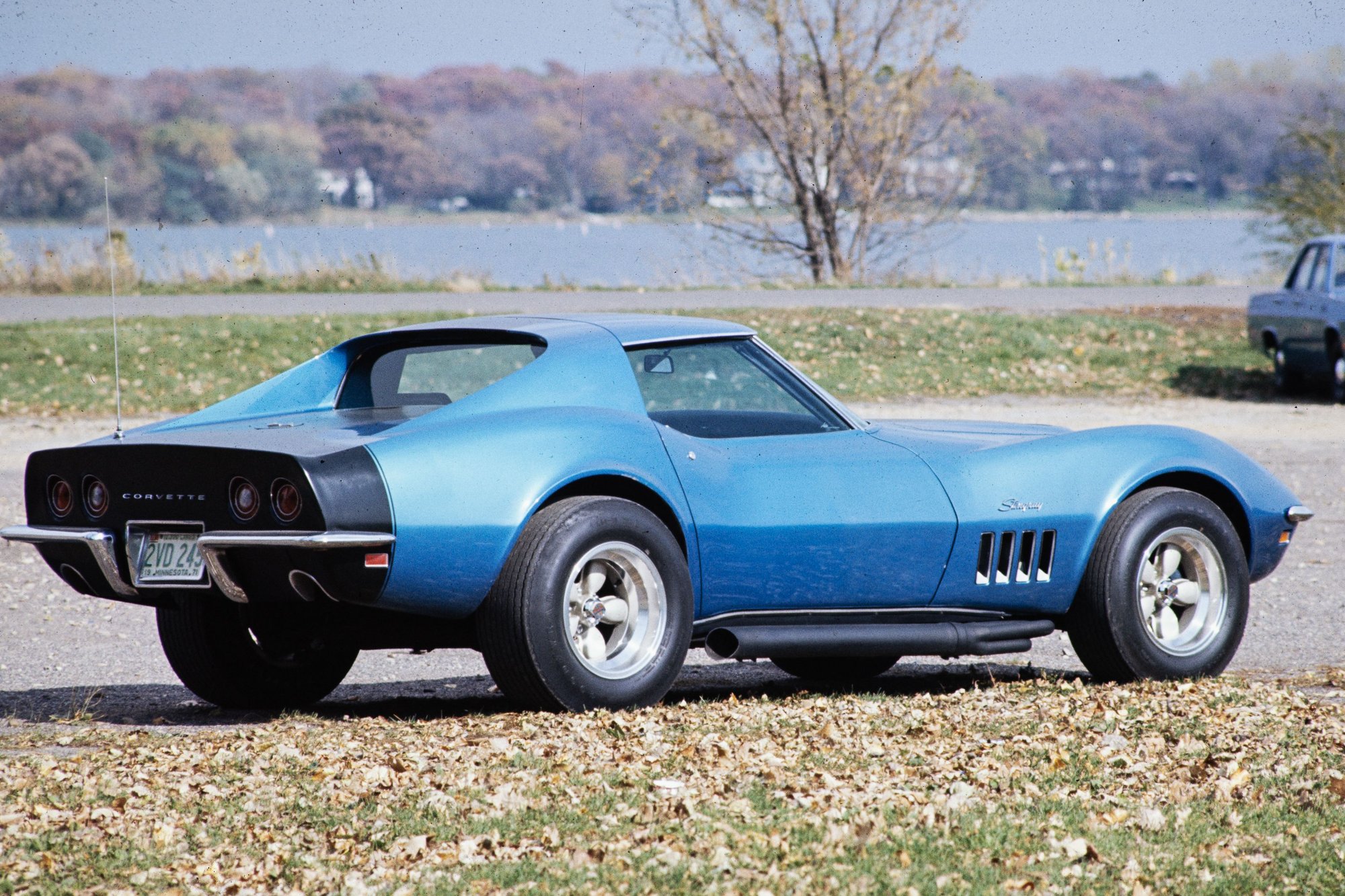

I have American 200s 15x10s’ with 3” backspacing on the rear of my 69 with all stock suspension. Wheel rim to spring is my closest potential interference and that is 1”. They clearly fill the wheel wells but never had any contact with the fiberglass.
This picture was taken in June of 73 when I first bolted them on. Those are Goodyear Polyglas GTs - L60s. Today, I have Mickey Thompson Sportsman SRs 28x12s.

The outer edge of the tread is right at the plane of the lip but there’s about an inch of sidewall that goes beyond. Thanks to the geometry of the IRS, the tire fits in the well upon full travel. The tire to frame at full travel is close but I don’t recall the exact dimension and have never experienced any rub.
With your offset arms, you may be able to fit the 12” but the section width of the tire will likely play into the equation. If your supplier is willing to play ball, have them mount up a tire and see. I would recommend that you disconnect the coil over and run the suspension to full up to be sure no interference.

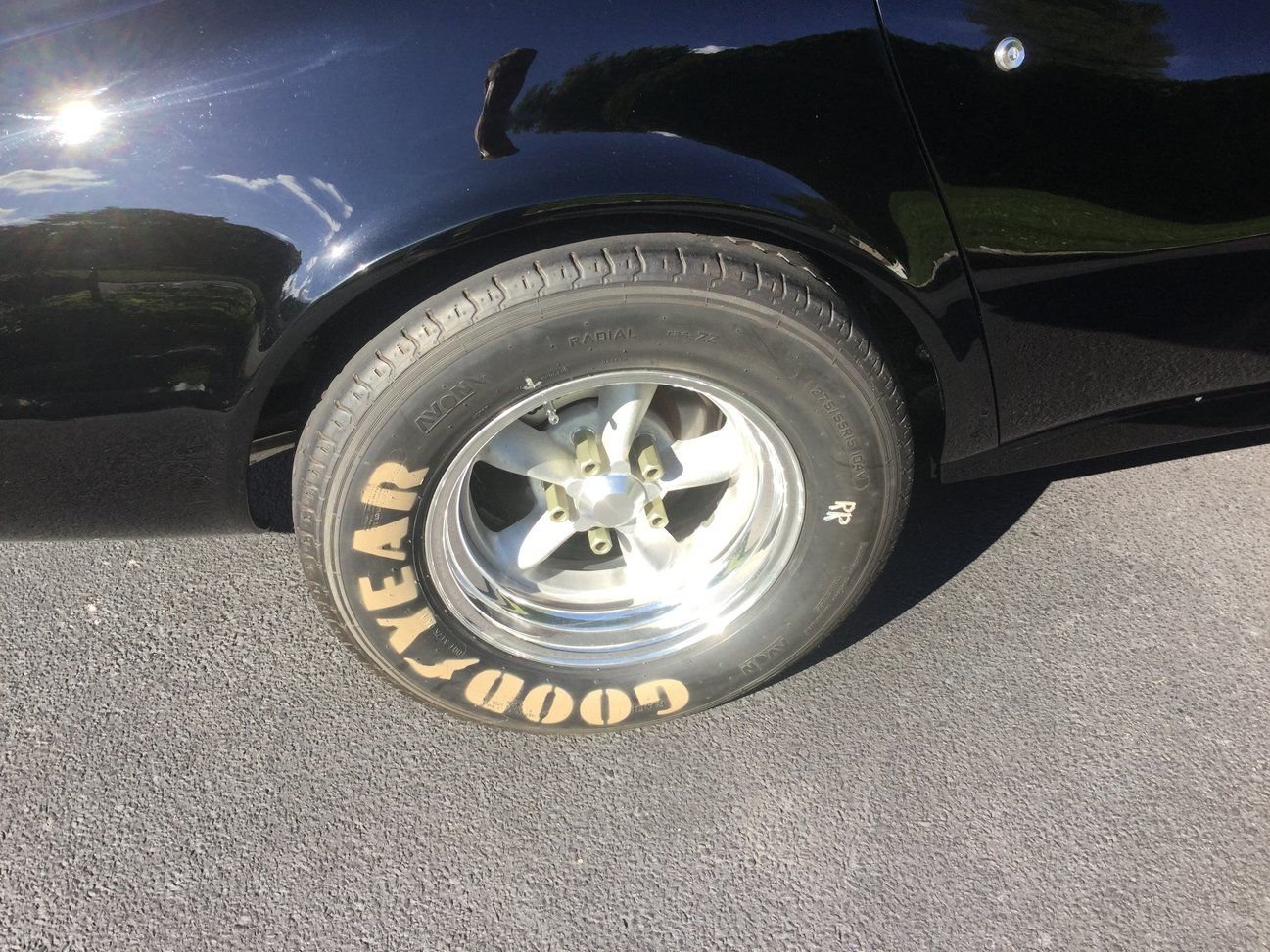

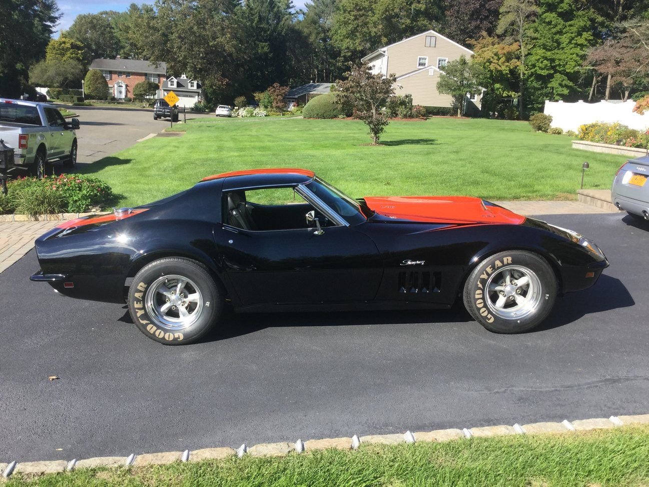

I dug up some other pictures and measurements I took on the Polyglas GTs before I bought the M/Ts. The section width of the L60s was 12.1 inches and tread width 10.25”. The M/T 28x12s are about an inch taller but otherwise are nearly a dead-on match.
After 45 years, the Goodyear’s are retired (no pun intended)
Fresh rubber again.

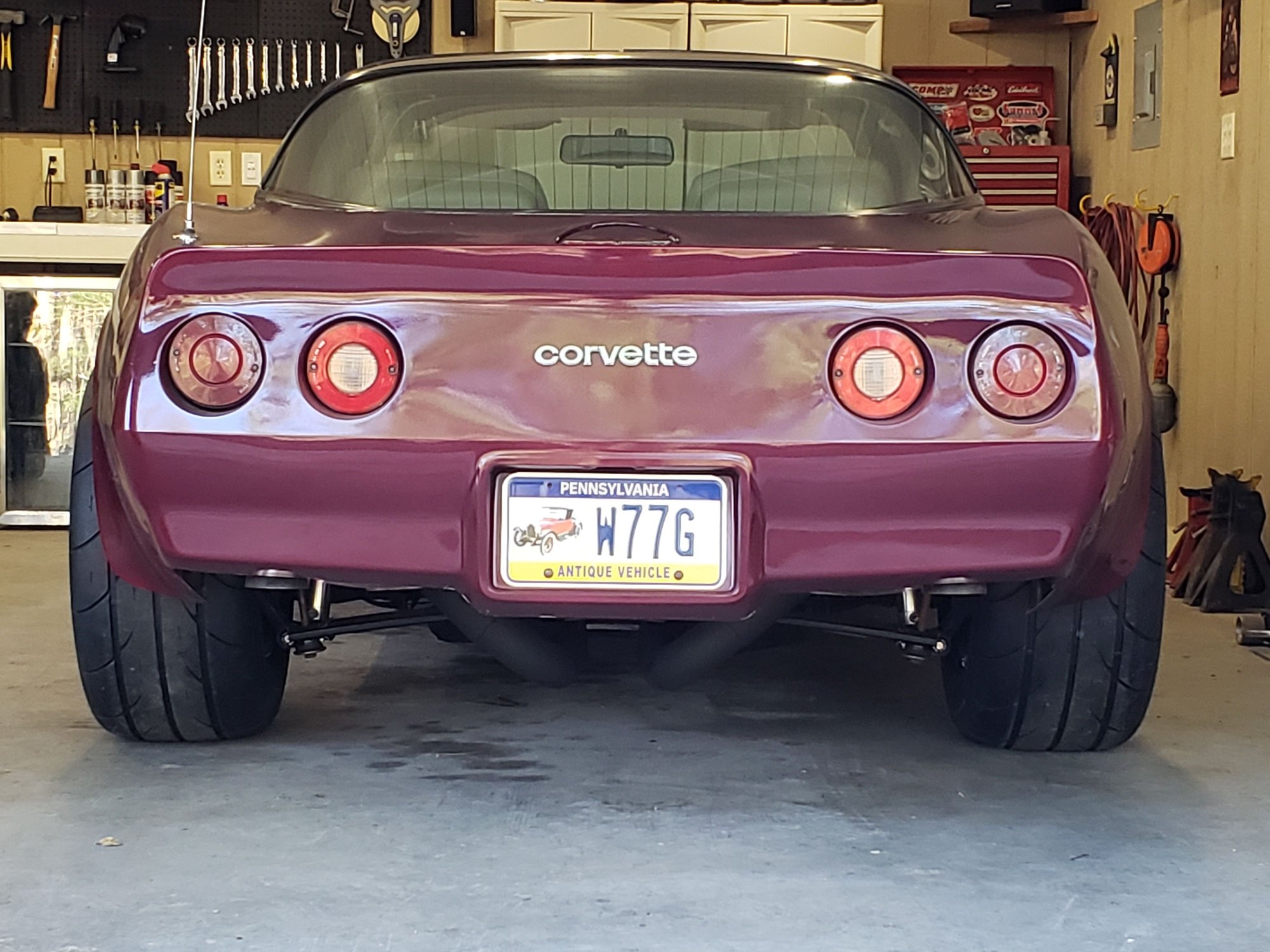

I run 15x10 Weld Draglites on the back of my 80, and wanted the same flush with the fender lip look, but have given up on that. The MT 295 55 15 drag radials stick out exactly one inch past the fender, and I think it's the best I can do without rubbing the frame. I tried thinner wheel adapters to pull the tire in and they rubbed. So my effective back space is five inches....but the tires do stick out a bit
