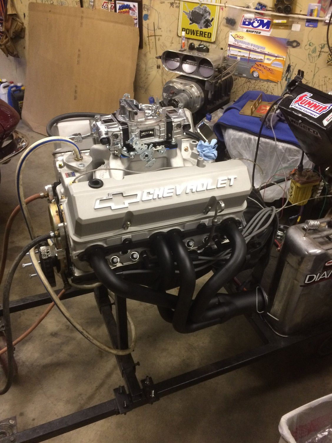

I have these:
​​​​​​http://xs-power.com/chevrolet-headers-4.htm
By far, the best deal in the market..........Read^^^^^^^
