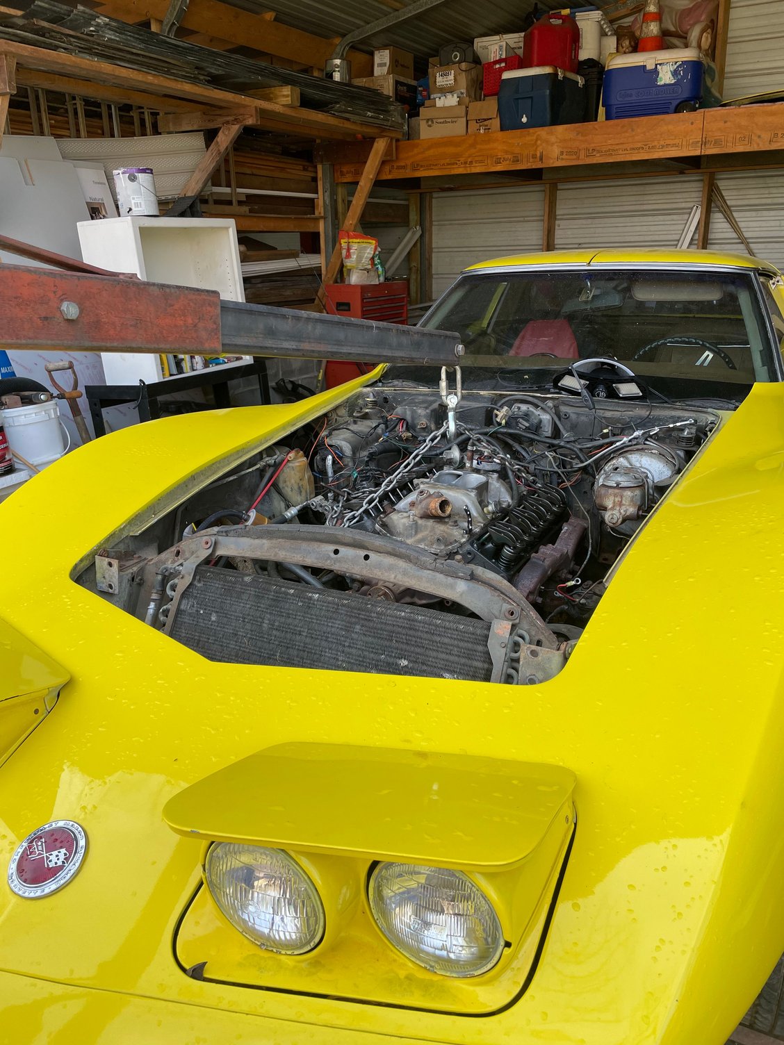

I just removed my engine from my 74 vette last weekend.
Where the car was sitting, it was nearly impossible to pull the engine from the side.
I rented a longer reach 3-ton hoist from our local tool rental shop for $25/day.

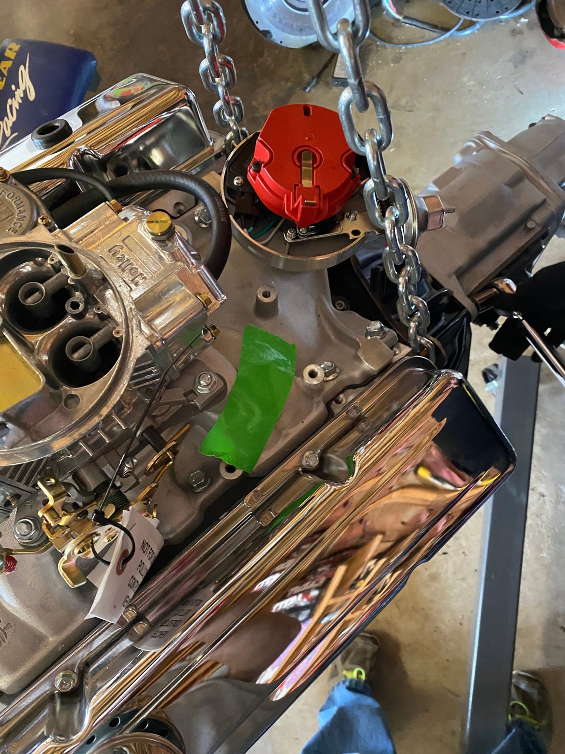

Unfortunately, the boom was still 6”-8” too short to reach, but I went to our Interstate Steel dealer and purchased a replacement 2”x3” inner boom pipe, and ordered it 12” longer than the original pipe. I drilled the bolt holes for the pin as well as for the chain.
Worked like a charm. I get to keep the extended pipe to use when it comes time to rent the hoist again to re-install the engine.
With the very short added distance of the boom, (8”) I seriously doubt the hoist will become front heavy as the rolling “legs” under the hoist extend way out there.
I hope to install engine/trans as one unit, but will carefully test the setup beforehand.

Agree and like 67:72 just did this job by myself twice on my 327 recent rebuild, messed up the cam on startup (another story) so the memory and experience is recent. I too used a HF engine lift as above. Got to have the 2 ton, I have another smaller engine lift but not enough reach. I have a HF gantry crane too, but I elected to use the HF 2t engine lift to better handle the engine/tran after you get it out. With the gantry, I would have had to roll the gantry or roll the Corvette so the engine lift seemed to be easier and more maneuverable . Also bought a HF load leveler. Got to have a load leveler, otherwise hard for me to see how you would angle it in, plus the leveler gives you more control. Took the rad/support/shroud out and removed intake/carb/distr/starter/fan/wp/exhaust hdrs. Also removed with the 4sp connected. Unbolting bell housing/trans and supporting under the Corvette did not seem like a good idea in a limited small space. Also put the rear on the tires on castors and pull the tires off the front and lower as much as you can. Turn the wheels hard right and access the engine lift from the RH pass side. I connected the leveler to the heads 4 corners with grade 8 bolts. I know some lift off the intake carb mount but that seemed a bit light to me. I also blocked up the tail of the 4sp level with the cross member to help guide it in better. All went well and the second time went a lot faster. So, I suggest be careful, go slow, try to keep your hands and feet out of harms way as much as possible. Hope this helps.

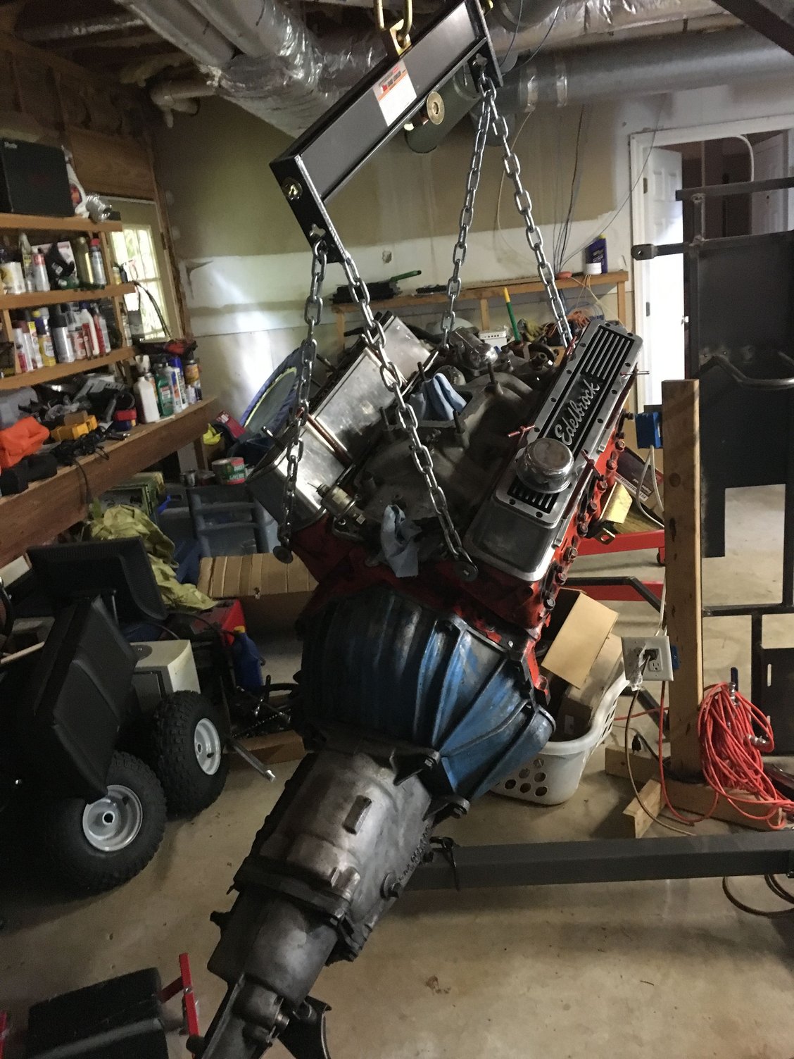

I pulled my old 327 with trans attached (4 speed) and installed my stroker 383 with trans installed using the HF hoist on the 1/2 ton setting from the side.

I decided installing both as a unit was better for me because I wanted to make sure the torque converter was properly engaged into the trans pump and could then mate to the flex plate with everything level and in a very controlled environment. I wasn't sure I could do that if working under the car that was only elevated a foot and a half off the driveway.
