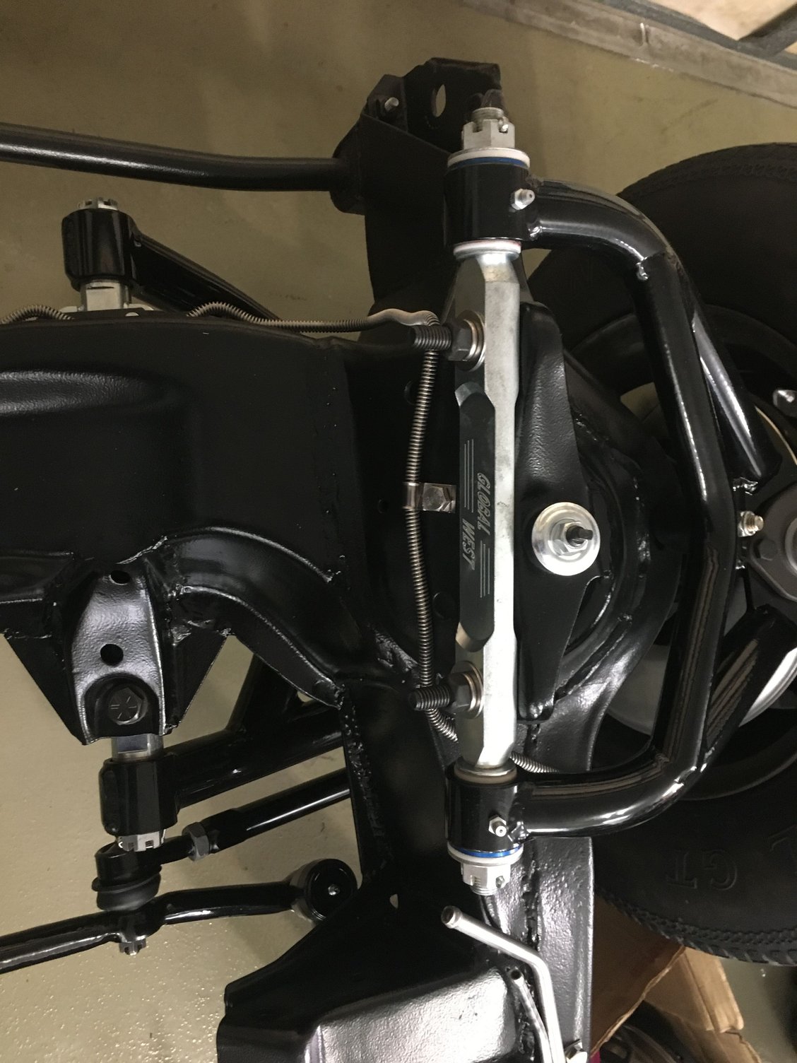

I have the global west front control arms installed and it was very simple to bolt them on and adjust the height. I went with the coil-over design instead of the stock spring. I also have the Van Steel Trailing arms. Van Steel has been excellent to work with. I had some shipping challenges with Van Steel and they made it right with 1 phone call.

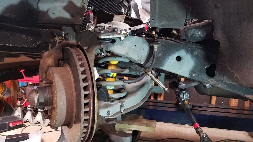

I used SPC adjustable A-Arms in my 80, which eliminates the need for shims.
SPC seems to have redesigned their arms to allow for threaded ball joints. I have the older style (still available on eBay) that takes the stock ball joint. I'll probably swap these to my 79 and upgrade to the newer style for my 80 when I redo my 79's front suspension.

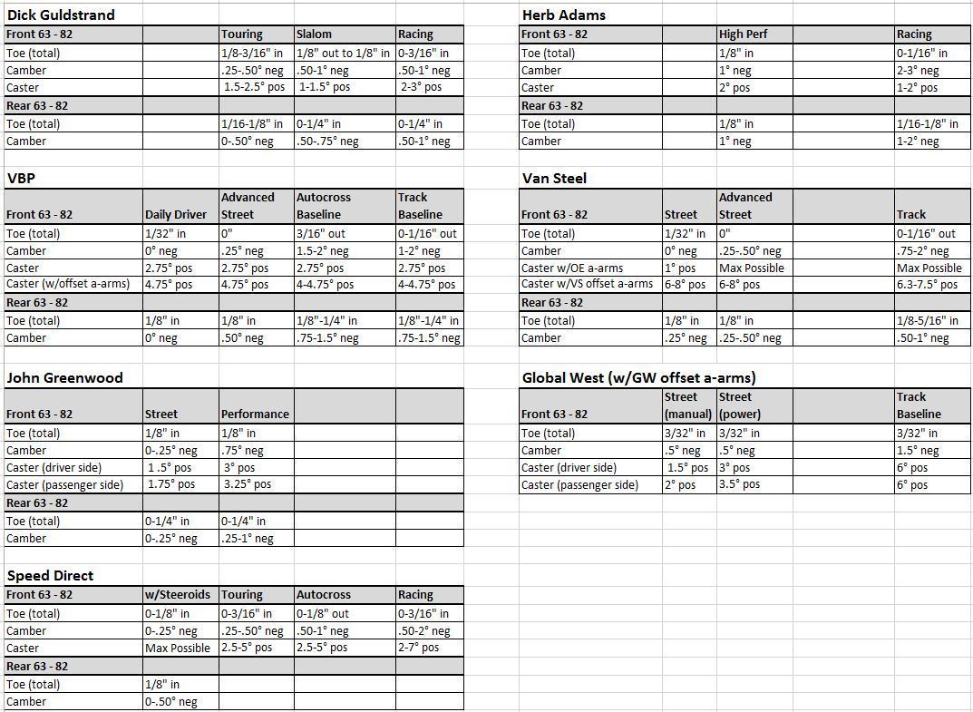

I went with VanSteel as well- front and rear. They have been doing it the longest(40+years)- have a great reputation- and think still give a Forum discount (10%?)
Here's a list fellow forum member "kidvette" on the adjust ability of the various manufacturers-.

Thats a great image! Thanks for posting.

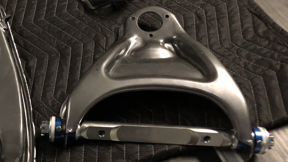

C2 of Year Finalist (appearance mods) 2019
Your arms with Del a lum bushing and offset global west upper shafts

Thanks for the adjustments specs too Richard! Very helpful 👍
