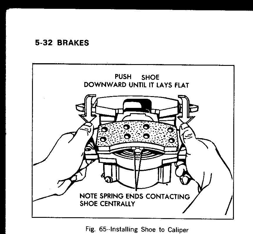

If you bought the caliper from your local parts store it came with 'lip' seals and when the piston went 'sideways' it runed the seal.
Just tell the parts person it leaks and they will give you a warranty replacement.
Use the pad to push each side down squarely and put a 1 1/4 socket between the pads and slip the caliper over the rotor.
