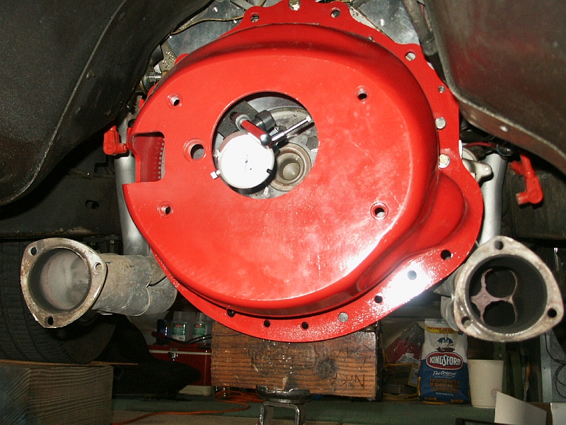

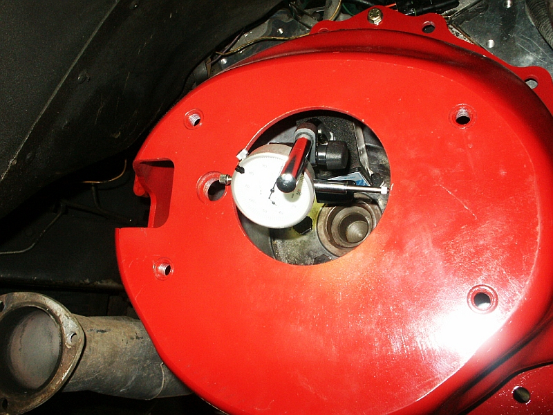

I bent the arm on my magnetic base for dial indicator. You think about offset dowels as cam lobes. I recommend the long allen locking type of offset dowels. You install them the same direction and move them in conjunction. So if you have .007 offset and they are both at 12 o'clock. You are raising the bell housing .007. If you rotate them both to 3 o'clock you have moved it right .007
